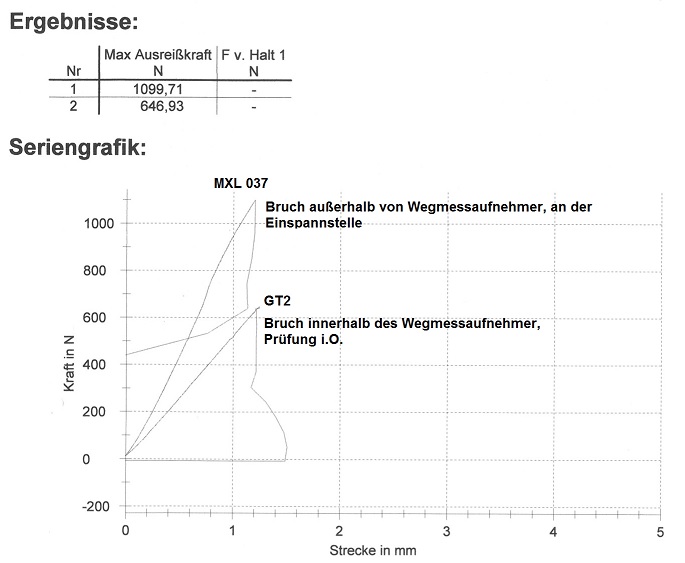

@Sven_Eric_Nielsen I’m 100% with you. But I don’t know the properties of the 2GT belt, because it isn’t branded. And until now, I don’t know the specs of the later used GT3 belt either (I have asked http://gates.com directly, also the vendor I bought it from, still no answer) So, noone knows for real. I know about a test a german http://reprap.org user did, very similar to the one @ChPech linked. He tested a noname-6mm-2GT vs an MXL-9mm. Not very fair, I know, but it did show the overall “stretchiness” of the 2GT belt, too. Graphic attached. What I want to say: It is striking, how much the nonbranded 2GT belt stretches, constantly, until it snaps, right from the start.

Amazing to me how many people have apparently tension-tested garbage off-spec belts without bothering to compare a genuine belt. The hell is the point? You’re not going to get any consistency or repeatability with trashy belts. Two different off-spec belts will test different, and there’s no way to tell what you’re getting when you order. The only thing you’re really learning is that cheap garbage has inconsistent and poor performance, which should be blisteringly obvious.

Based on the published belt specs, this is how genuine fiberglass core GT2 should approximately look overlaid on the Reddit tensile test chart. (6cm long test sample.)
Should be pretty clear that one knockoff belt tested was fiberglass but low quality (premature failure) and the other knockoff had a polymer tensile member (polyester or nylon) which is completely unsuitable for 3D printers. [EDIT: details in Reddit thread said the junky belt had the elastomer separating from the tensile yarn (junk!) so the tensile member wasn’t carrying load effectively.]
