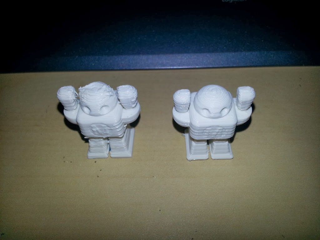

Follow up to the my question from this morning.
Follow up to the my question from this morning. these two are printed with the same slicer settings using octoprint on a pi. the left one was sliced with slic3r and the right one with cura. the flash makes it look like it has more z wobble than it does, but the artifacts are gone and I finally figured out that the warts on the back of the left one actually say make:
It’s likely because Slic3r does this thing where, if you have multiple towers, it’ll do them in 1, 2, 3, [next layer], 3, 2, 1, [next layer], 1…
This means that towers 1 and 3 get 2 layers printed one right after the other.
I think the current cura does this, too (printing on the same island twice). Old versions based on Skeinforge didn’t. Never had trouble with that new order, though.
@ThantiK yeah, it means that even though the print may be faster because there is less travel, the towers get goopy from being heated from the extruder for too long.

I didn’t even pay attention which way slic3r and cura did the three towers . but even on the single body slic3r had artifacts and you couldn’t make out the word on the back at all
