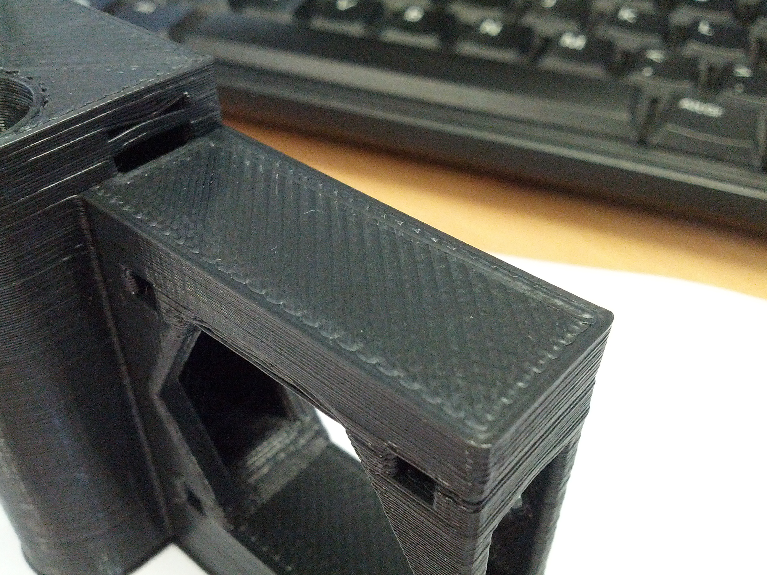

Following @ThantiK experience I decided to sand the nipple off my jhead nozzle. Its improved the quality of the solid fills significantly. I still need to address the poor bridging, retraction and add a fan but I’m making progress.

It was a MK-IV-B. I bought a new one last week (MKVI?) So if it didn’t work I had a back up. I’m well pleased with the results. I only used 400 grade sand paper but it leaves the filament with a polished finish. Great little mod.

Thanks @ThantiK and @Daniel_Wood I filed my nib off last night and have had great improvements in the top surface of prints! Mush have changed the extruder dynamics a bit though as it looks like I need to recalibrate the multiplier as I am under extruding now…
