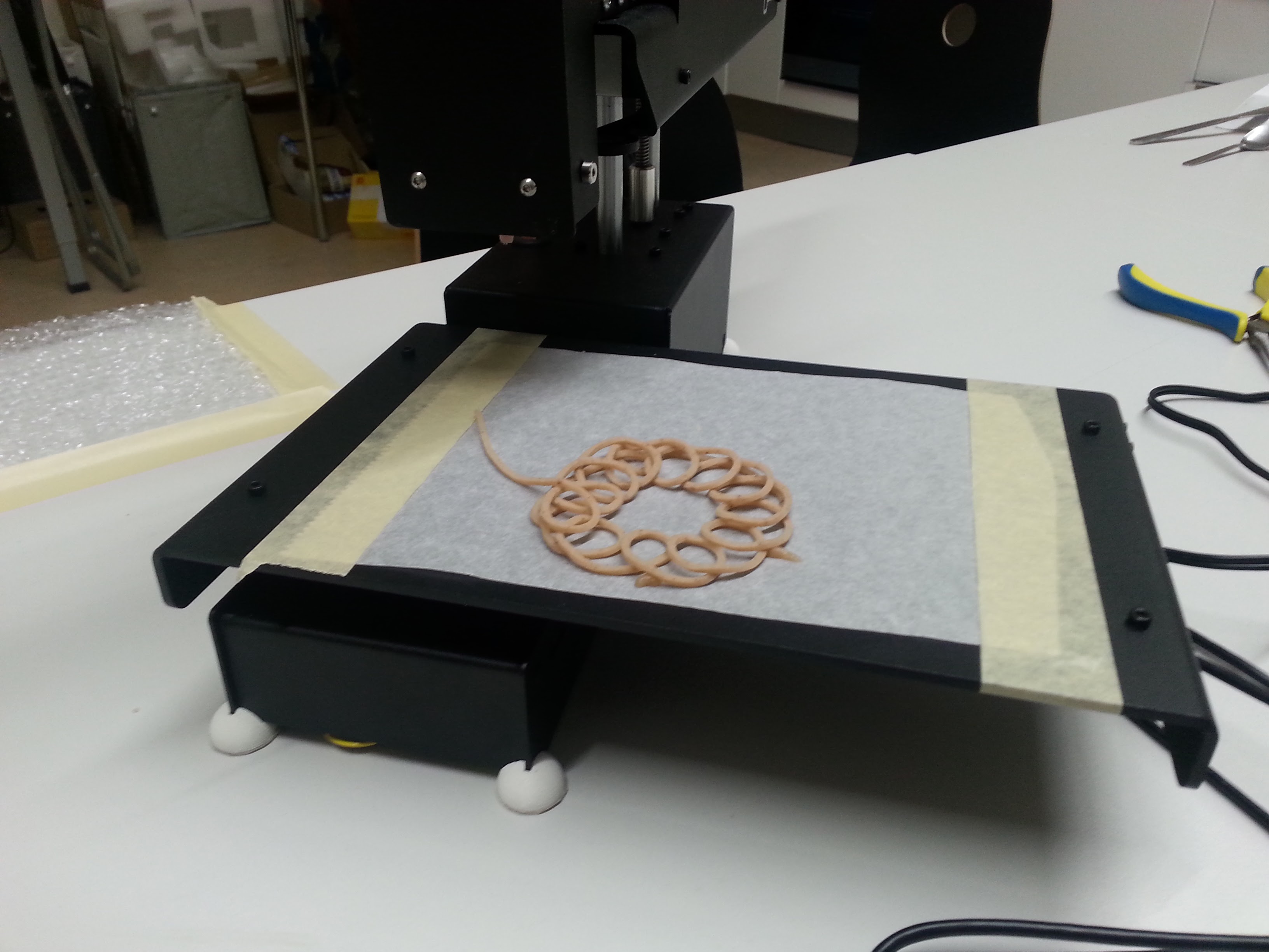

Food Extruder: After a (too long) break this job returns back to my desk...
#Printrbot Food Extruder: After a (too long) break this job returns back to my desk…
I’m getting closer to a working setting. At least I got curled spaghetti on the printbed (actually it’s chestnut paste). :slight_smile:
To do or to fix:
  • Get a paste, which sticks better to the bed, but not to the nozzle.
  • Fix the settings: start.gcode and more…
All the improovements were achieved with the standard Printrboard firmware. By now no luck with the PasteExtruder FW.
