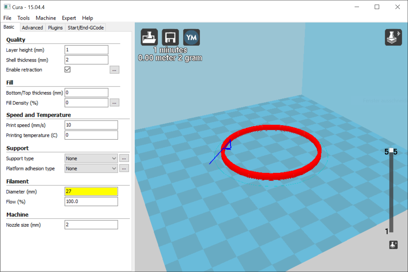

Now the printer homes nicely (after reflashing the new firmware). Everything seems to be OK. The test object will be a ring (actually it is a disc but I set the “Bottom/Top thickness” and “Infill” to 0).
Before I hit [Print], I set the start position manually.
Then the printer moves very strange. Did I mix up the “start.gcode” part? Some lines are already commented out.

Define very strange:
  1. It moves to the start position. OK
  2. It should “draw” a nice circle onto the printbed. But it doesn’t: It moves like a “jerk”.
@Whosa_whatsis No, no LCD attached. But I run a couple of #Printrbots without LCDs and they do fine.
What do you mean, “it moves like a jerk”? Don you mean it moves way too fast? Does it go in a circle, or does it just move a little and then stop? Also, does it do the initial extruding before it prints properly?
@paul_wallich ​ Hm, it’s difficult to describe because the printer is in the lab and I’m at home. :wink: But let me try:
It moves like printing infill between two narrow walls. But no circles!
From that it sounds as if one of the steppers is skipping steps. Unlikely, I know, since you say it’s moving smoothly otherwise. Maybe you could try a bunch of moves and extrusions under manual control.
