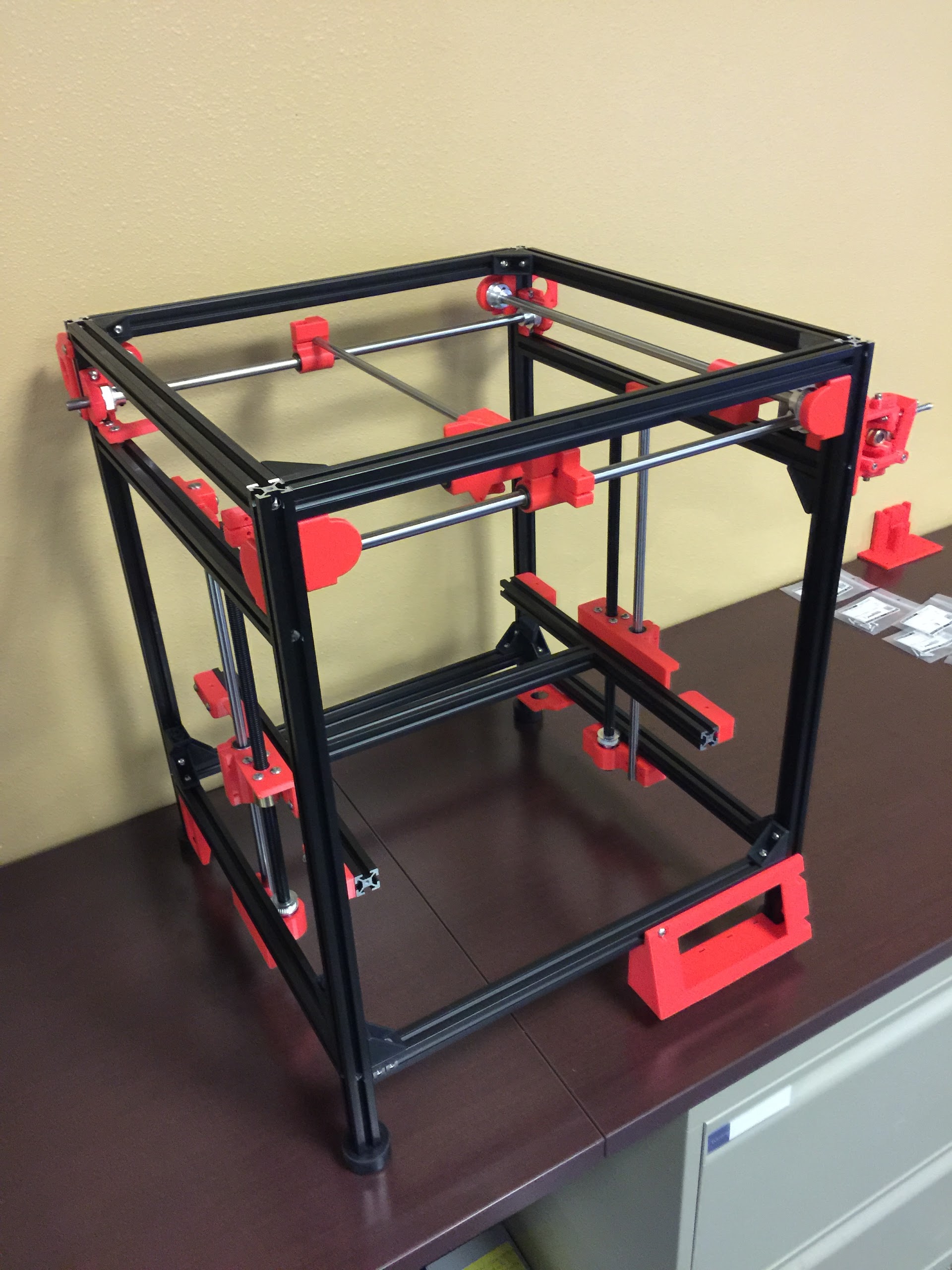

Holy T-Nuts! I pretty much tore the entire printer apart adding those last few T-Nuts I needed for holding the Plexiglas. What a pain!
Not sure if I got the answer on how to mount the electrical equipment underneath the Eustathios Spider V2. Is it glued on or are there holes drilled in the Plexiglas to hold it from above?
@bcrazycramer I just drilled the holes by hand. Never modeled it. So many people exchange electronics, don’t want holes that don’t line up. Also I should add some drop-in T-nuts to the BOM for things like this
@Eclsnowman Wait… They have drop-in T-nuts.
Drilling the holes seems easy enough.
