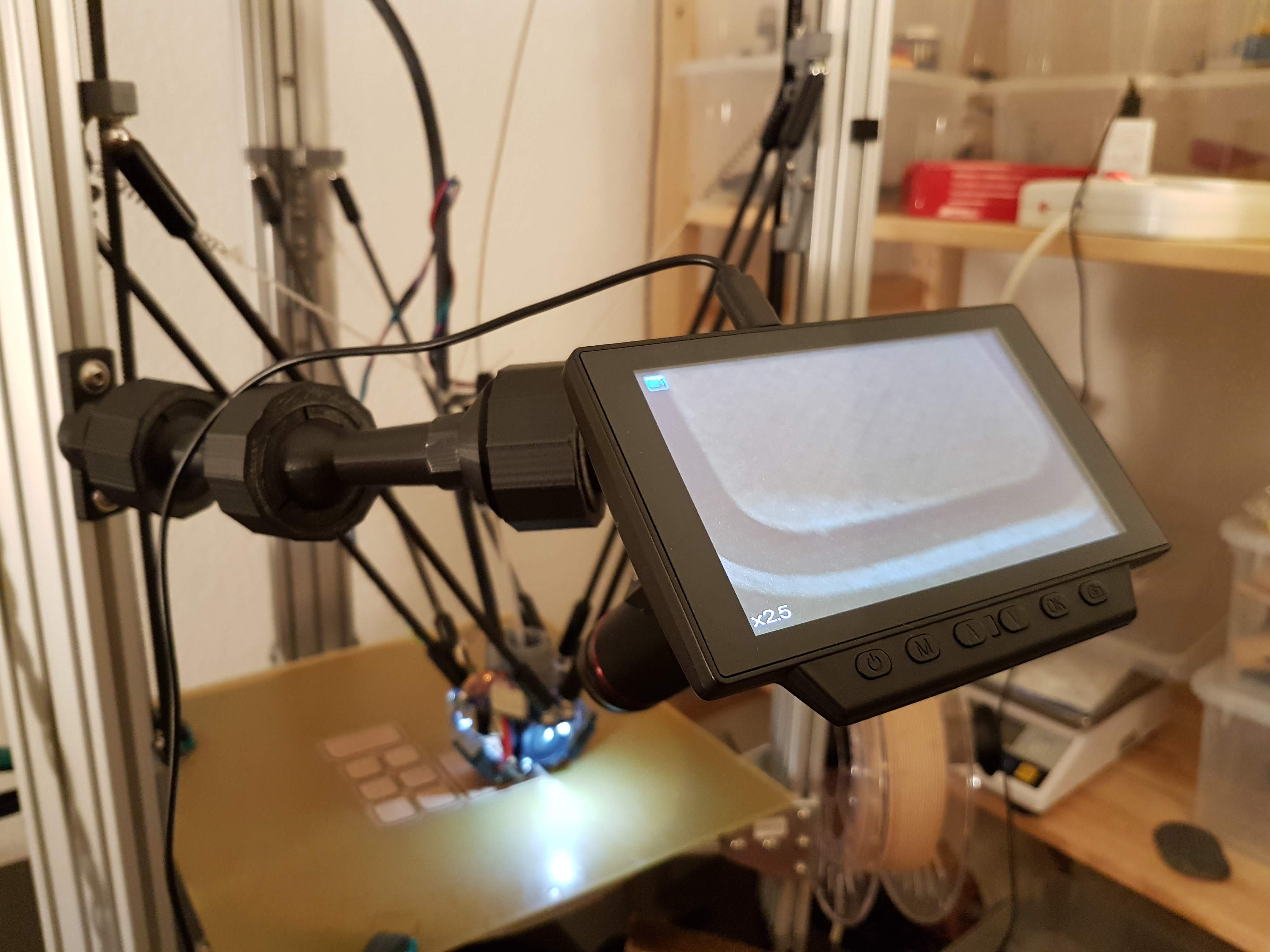

For Andonstar ADSM302 I designed a Ball Joint System with a Snap Buckle Clamp.
For Andonstar ADSM302 I designed a Ball Joint System with a Snap Buckle Clamp. Now I can observe quality during print very well.
STL:
https://gitlab.com/heapstar/3d-design/blob/master/Workshop/ADSM302%20Ball%20Joint%20Stand/ADSM302%20Ball%20Joint%20Stand.stl
CAD:
https://cad.onshape.com/documents/d47d1b3d118b03702552d6b0/w/7b3361979ebfa52dc8c0d3ba/e/42e1064ead3fc53531143b69
Interesting. That gives me some ideas about RAM mounts.
Thank you for sharing.
The locking ball joint is something that has lingered on the back of my head for years. Seen it on hackaday I believe first and was curious how it performs ever since. Yours is a static bed so not much jerk going into the joints, maybe just vibrations of the frame. It looks good though.
