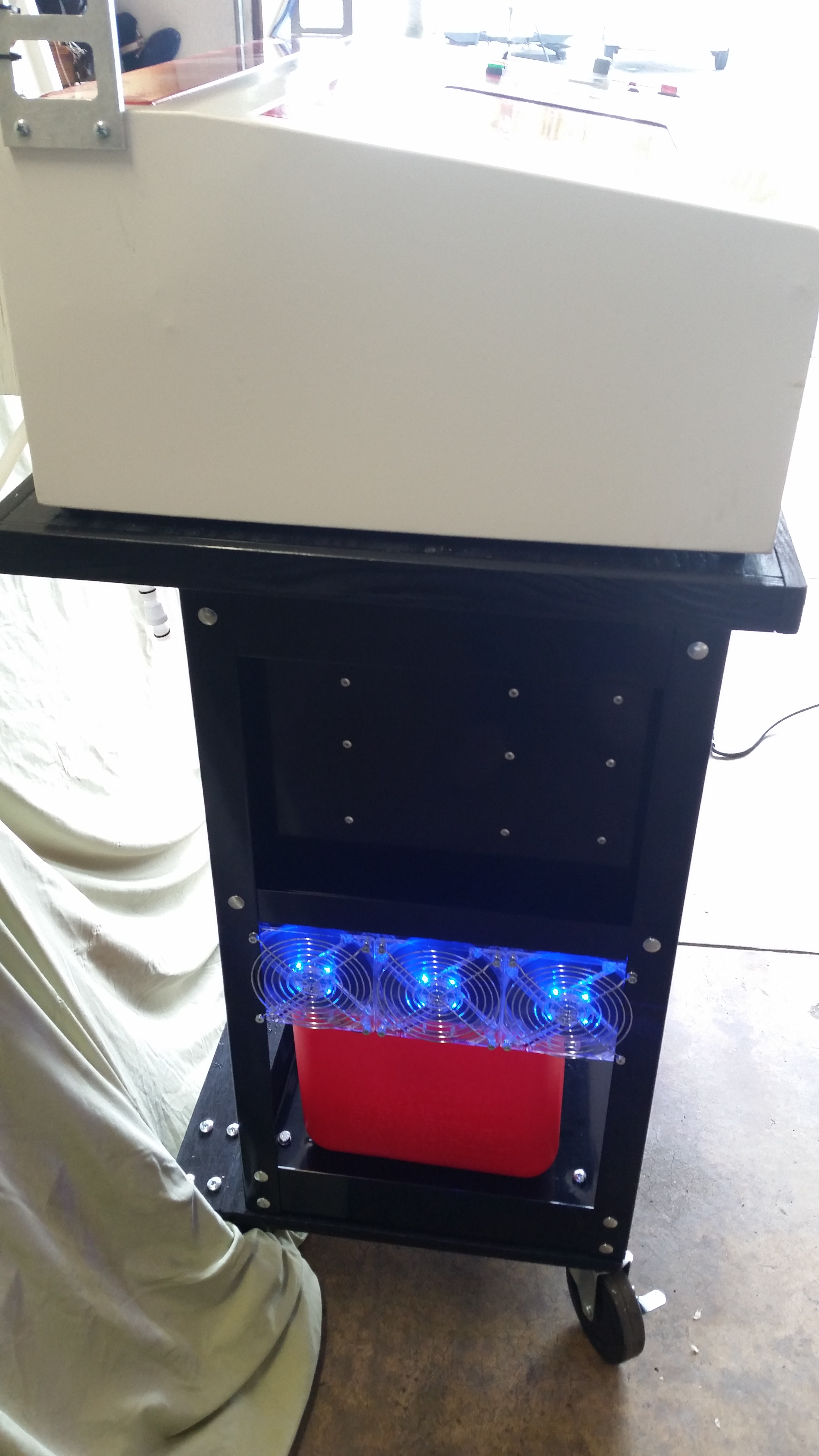

So… to start, Walmart had some 5 gal. plastic gas cans on sale for 12 bucks so I bought one of those for the tank. I drilled two ½ inch holes in the top and inserted the hoses so both are always below the surface and give me the closed system. This way you didn’t have to pump air out of it every time you turned it on. The hose I used (described below) is 5 x 8mm just slightly over ½ inch so it provides a nice seal.
I bought another aquarium water pump to replace the old one but it IMO did not pump enough to give me the flow I wanted. I decided if I was going to do it , do it right and did more searching finding a Little Giant 2-MDQ-SC Water Pump for $108 including shipping.
For coolant I decided to go with a purely deionized water system and use the Tetra Algae Control based on Don’s testing and postings.
Next I replaced the coolant line with 5X8 silicon flex tubing from Lightobject for better flow, added a temp probe, pressure and a flow sensor inline.

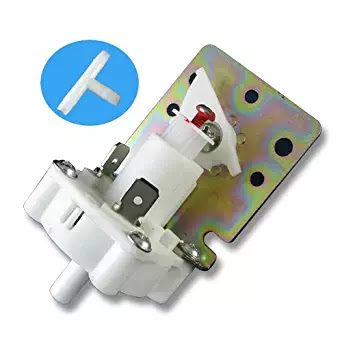

The pressure sensor LSR- H2OPRSNR (Lightobject) has a port for connecting the hose that was too small so I epoxied a larger rigid tube on it to fit the new hose added my own larger ‘T’ and tossed theirs in my parts bin. It’s wired series into the beam interrupted switch.

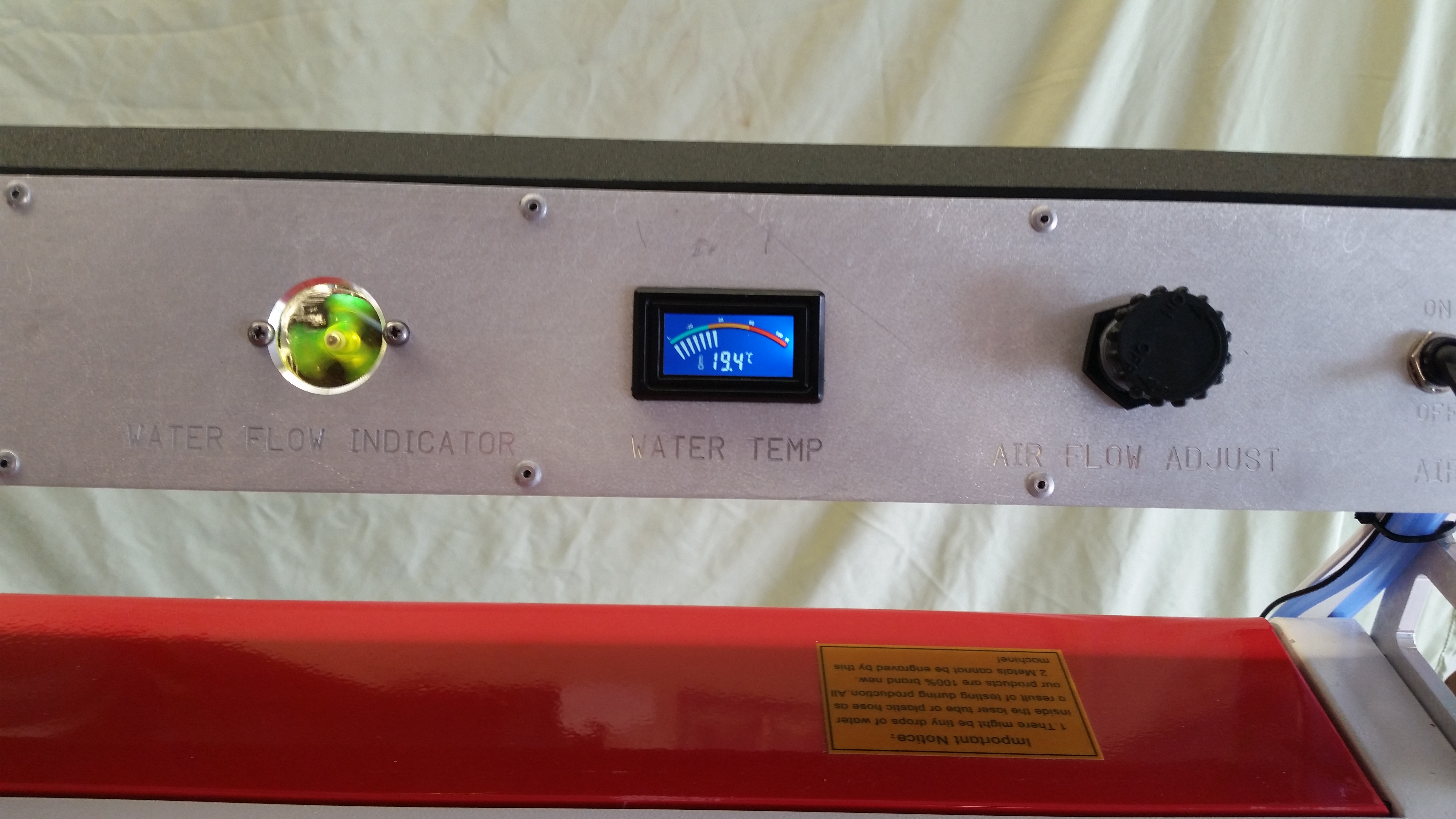

The lighted visual flow paddle wheel was off E-Bay and mounted on a control panel I had fabricated up.

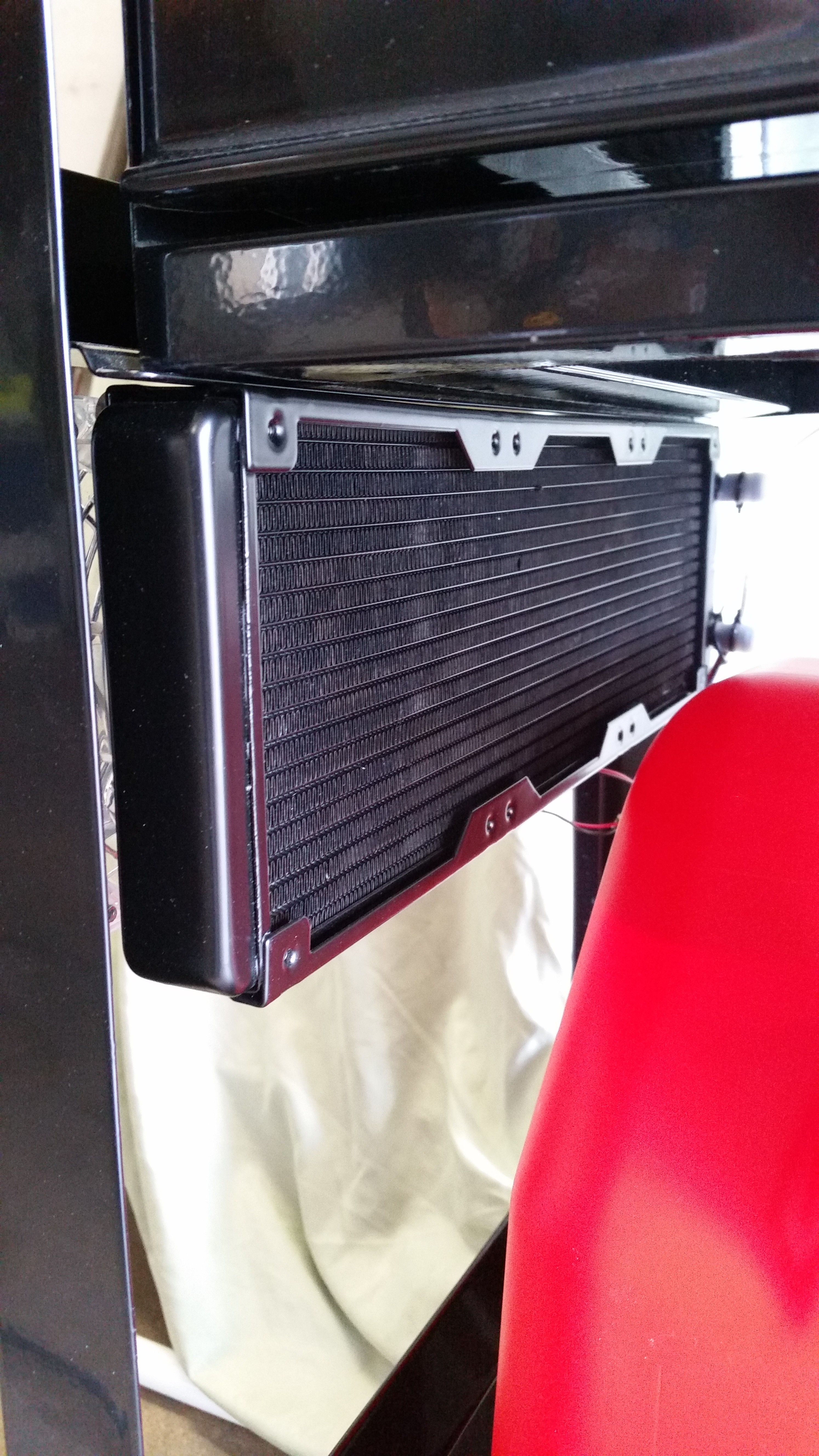

For more cooling I also added a 120 x 360mm radiator and fan system (I’m not so fond of the blue lights but the price was right).
All these 12 volt items I added are powered off a 12 volt power supply I happen to have.

Temperature gauge is here…
Be aware, this radiator does not come with the fans. You need to buy them separately.
Fans here are somewhat low speed but quiet… 12 v
http://www.ebay.com/itm/272369690524?_trksid=p2057872.m2749.l2649&var=571281183940&ssPageName=STRK:MEBIDX:IT

Steve, is the visual paddle wheel flow indicator visual only, or does it tie into the laser disable or interlock electronics? I see in your design you do use a pressure switch which is tied into the machine electronics. You might consider upgrading that to a true flow indicator.
If you have a kink in the water line past a pressure switch the switch would happily report pressure seen from the pump, despite the fact that no water is actually flowing in the backed up system. The flow switches I’ve seen on eBay detect actual movement of the water, and are harder to fool. One is like a spring-loaded “doggie-door” with a magnet. When water is actually flowing the door is pushed open and a magnetic reed switch is activated.
BTW, that pressure switch you referenced from LightObjects is actually a washing machine pressure switch. It’s commonly used in laser cutters. The rear side is where a shaft sticks out to select “Small”, “Medium”, or “Large” washing machine loads. (It’s probably been cut off.) When ours failed after two years, it was the rubber diaphragm​ that split and leaked. Apparently in the washing machine environment they are not intended to be pressurized for hours at a time as they are in a laser cutter.
