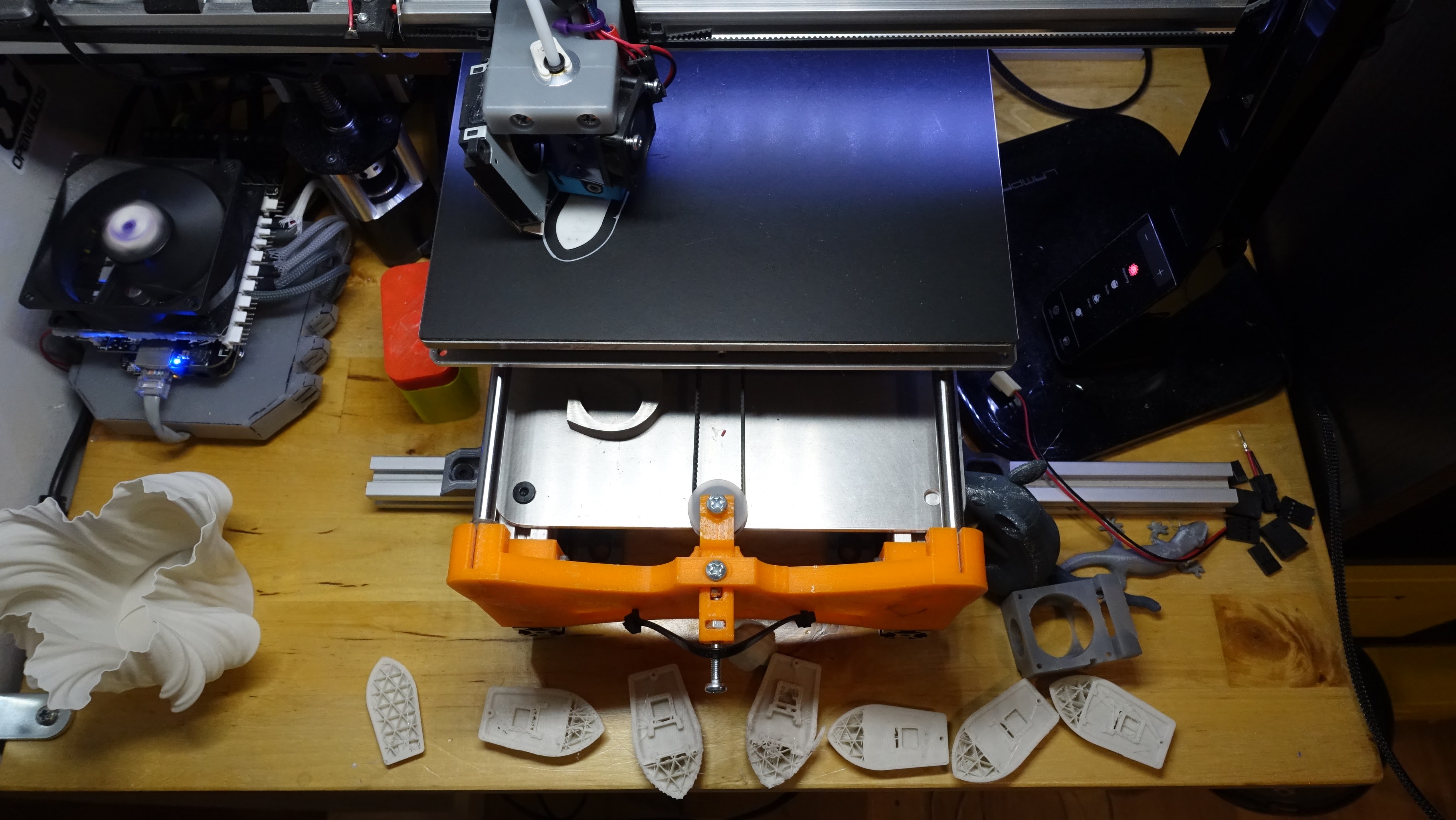

For obvious reason (crane style) I've opted for bowden setup and now I'm battling
For obvious reason (crane style) I’ve opted for bowden setup and now I’m battling with jam/filament grinding issue. My current setup is with E3Dv6 and titan. Things I’ve noticed and tried to mitigate but still no success:
  • PLA slowing down print speed to 40mm/s
  • vase mode no jamming. Rapid retraction appear to be causing the issue here.
  • lower retraction length down to 2mm per E3D recommendation.
  • lower retraction speed down to 20mm/s
  • up temp print to 210°c
Those with bowden setup your input is greatly appreciated as my collection of failed benchy is quickly piling up…
