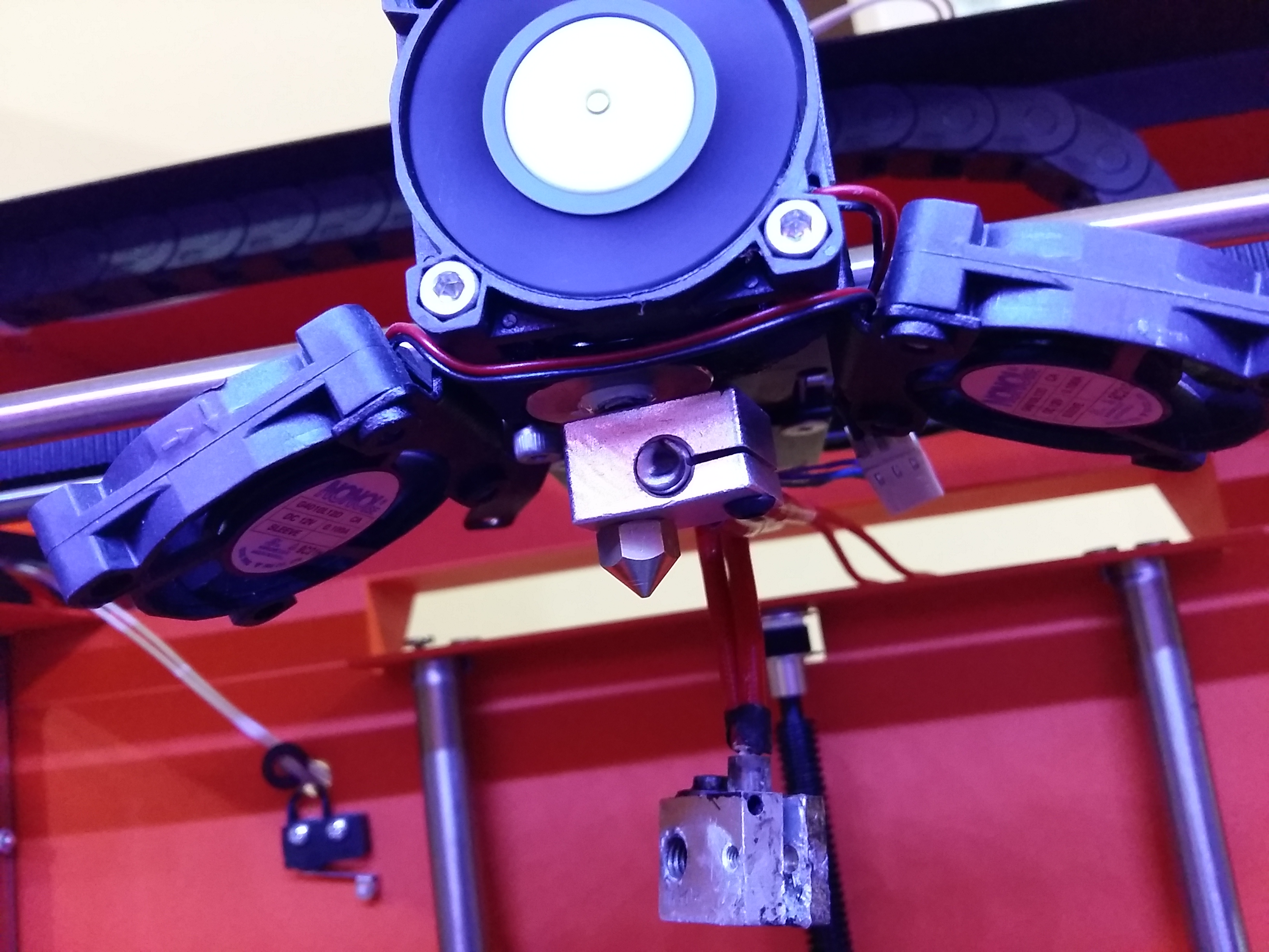

For some odd reason my extruder temp is jumping back and forth about -+ 10 degress, i first suspect it was a bad cartigre, but as you can see im using a new block, cartigre, but i get the same issue, any ideas?
Im using a craftbot

Could you try a different fan setting? The fan that cools the cooling fins of the hotend may be getting cooled too much of the air might to be kept away from the heat block.
There is a chance that the part cooling fan might cool the nozzle if it is blowing too hard.
I typically run the pid auto tune with the nozzle close to the bed and the fans on full
Is the sensor in good secure contact with the block? Is the heater secure? Is the heater from the manufacturer? If the heater is too far off original spec then the stock tune can be incorrect for the new heater.
might be the small screw that holds the PID sensor not tightened enough
