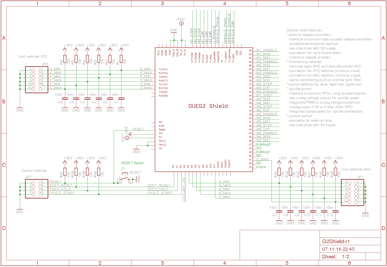

Based on the above and the idea of the G2 shield mentioned in https://github.com/labsud/GTwo, I decided to make a design for a G2 Due Shield that is more tailored to my situation:
- Can connect up to six external stepper drivers with optocouplers (like TB6560, TB6600, etc)
- Can connect limit switches for both XYZ and ABC axes and includes signal conditioning for them
- Spindle interface (enable/dir), with pwm-to-analog conversion for speed control
- Connector for coolant control relay
Hope it gives others some inspiration. Also it would be great if you could share your comments or suggestions for improvements on this design.
