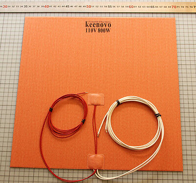

For the heater. would this do? it matches in spec minus 30mm
im just not sure if there was another typo @Eclsnowman

Keenovo is good, I had them custom make me heaters for my printers. Other people should weigh in on whether AC is a good idea here, you’d need an SSR to switch it. 24v would be fine for this size. I’m running slightly smaller ones on 12v which is probably not a good idea for this size but 24v dc would be ok.
how would i run it on 24 v with ramps?
or even the azteeg. they are both 12v…right?
120v is totally worth it. The ssr makes for much less stress on your controller and your bed will heat in a couple minutes.
So the bed connects to the ssr and the 12vdc psu? But how can a 800w mat be powered by a 450w psu…wait…is it a voltage difference?
How does it even get 110v
It’s wired to mains. On mine its in parallel to the power supply. The positive leg is switched with the ssr. Negative goes back to the neutral leg.
Ahhh I get it. I also looked at the wiring diagram. Didn’t think I would seen it there. Makes sense now

Also got my 2 heaters from Keenovo… both 230mmx320mm 500W@110V(runs at arount 550W because its actually 120V on the mains line.) Both still work great. paid 100$CAN in total… about 2 years ago.
I should point out that, you should put a thermal fuse inline with the mains line (install the fuse on the bed and make good contact. the reason is that, #1 a SSR can short out. and #2, your on main line. those heat up real hot on continous power feed ![]()
I have one and it works great. You do have to use an SSR and run AC through it. Here is a good guide on solid state relays: https://www.youtube.com/watch?v=TiEwNf1H_Tc
