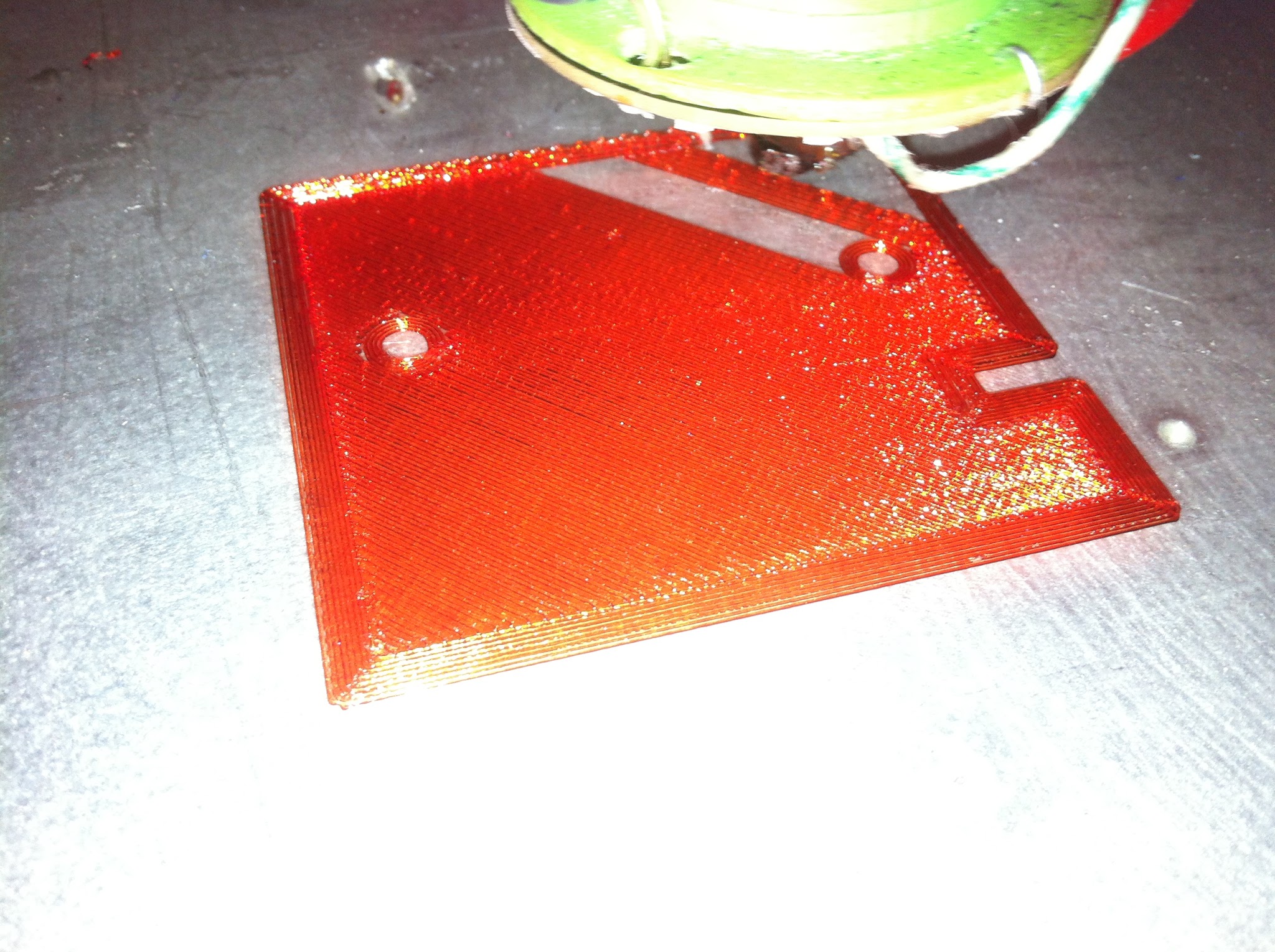

For the people that are having trouble with PETG, like I did, this kind of first layer is possible.
@Rien_Stouten I’ve never printed PETG but would like to. What do I need to watch out for?
@Duncan_Gunn Normal settings didn’t work for me at all. The PETG seems to swell a lot coming out of the extruder. So it seems to like to ‘AirPrint’ . A very low extrusion width factor works, no retraction, but stopping the feed a little bit before travel helps, and printing at least 10 degrees hotter than recommended by the filament supplier. This way I get great results, no warping, and extremely strong parts.
With ‘normal’ settings I got a lot of blobs, and awful looking parts. A common advise you will hear is to print slowly with this material, but I print at 100mm/s with no problems. The top layers I print at 50mm/s, for a smoother surface.
Ya, I had blobbing problems from what I think is back pressure build up. I had to reduce the multiplier to 93% and boost extruder temp. Still get a little build up on the nozzel, but the parts print better and faster after that multiplier change.
