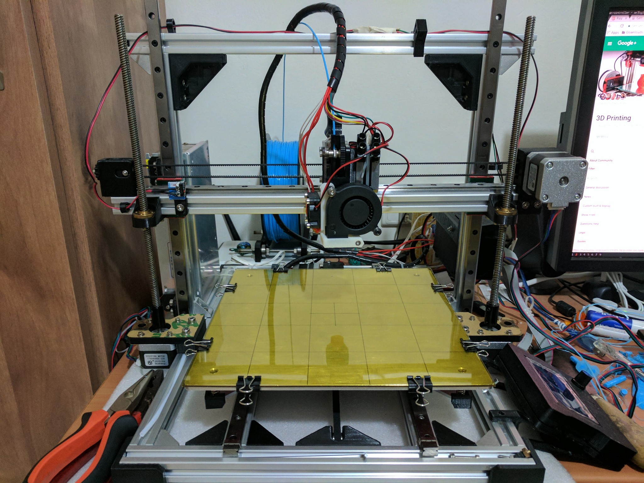

For those interested, and able to get a hold of a $199 prusa i3 upgrade kit, we built a printer around the kit that uses high quality genuine Hiwin rails, and precision waterjet parts, along with a bondtech extruder to achieve a very solid platform. It uses all stock prusa firmware, slicer, etc.
Follow along on hackaday: https://hackaday.io/project/19305-3d-printer-on-rails

that’s pretty similar to what i have on my test machine (please ignore the wire management which is going through changes now).
i am actually now comparing a stiff coupler to a flexible coupler to a top mounted belted system, and it seems that with this rigid a build it does not even matter, no z wobble what-so-ever in any of the setups!

Did you make the same pcb heatbed as them, for alignment? Or could it be that with a single machined baseplate, all the alignment issues are taken care of?
@raykholo the i3MK2 pcb heatbed comes in the upgrade kit, so we are using it. I dont expect alignment to be an issue, but since we are using the prusa bed, sensor, and software, it will not be an issue. Sidenote, I am planning on given cohesion a run on this machine, it should be pretty sweet with smoothie too!

@Anthony_Webb since all the calibration stuff was written into Marlin and is not in smoothie, I am of the opinion that the sheet metal work will be precise enough. I have folded sheet metal machines I designed that don’t even require any bed leveling, so I am confident that it should be naturally square enough. As long as the mounting holes for the motors and such don’t have any clearances :slight_smile:
I like it, I imagine about $450 in hiwin parts? Are you going to offer any kits?

@Brad_Hill The hiwin bits run about $300 shipped to USA
@Eric_Davies calm down, I dont see how print quality could be much better than the MK2, I have that printer already, and I absolutely love it. It is “near” perfect. I will say, after printing with the MK2 for several months now though that the machine is starting to rattle (prints are still fine though) I am thinking this is due to the bearings being attached with zip ties. The goal of my new build is to use all the things that IMHO make the MK2 hands down the best FDM you can buy now (bed, level sensors, calibration, and software) but improve on the linear motion bits replacing zipties and printed parts with precision rails and robust aluminum brackets. What will the end result be? That is still to come. I’d highly recommend the MK2 to anyone. But I’d prefer to spend the money on proper linear motion bits. We’ll see how it shakes out.
