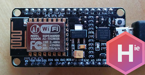

Nodemcu?
NodeMCU what? The hardware, the firmware?
This development kit named Nodemcu.based on ESP8266, integates GPIO, PWM, IIC, 1-Wire and ADC all in one board. Power your developement in the fastest way combinating with NodeMCU Firmware!
