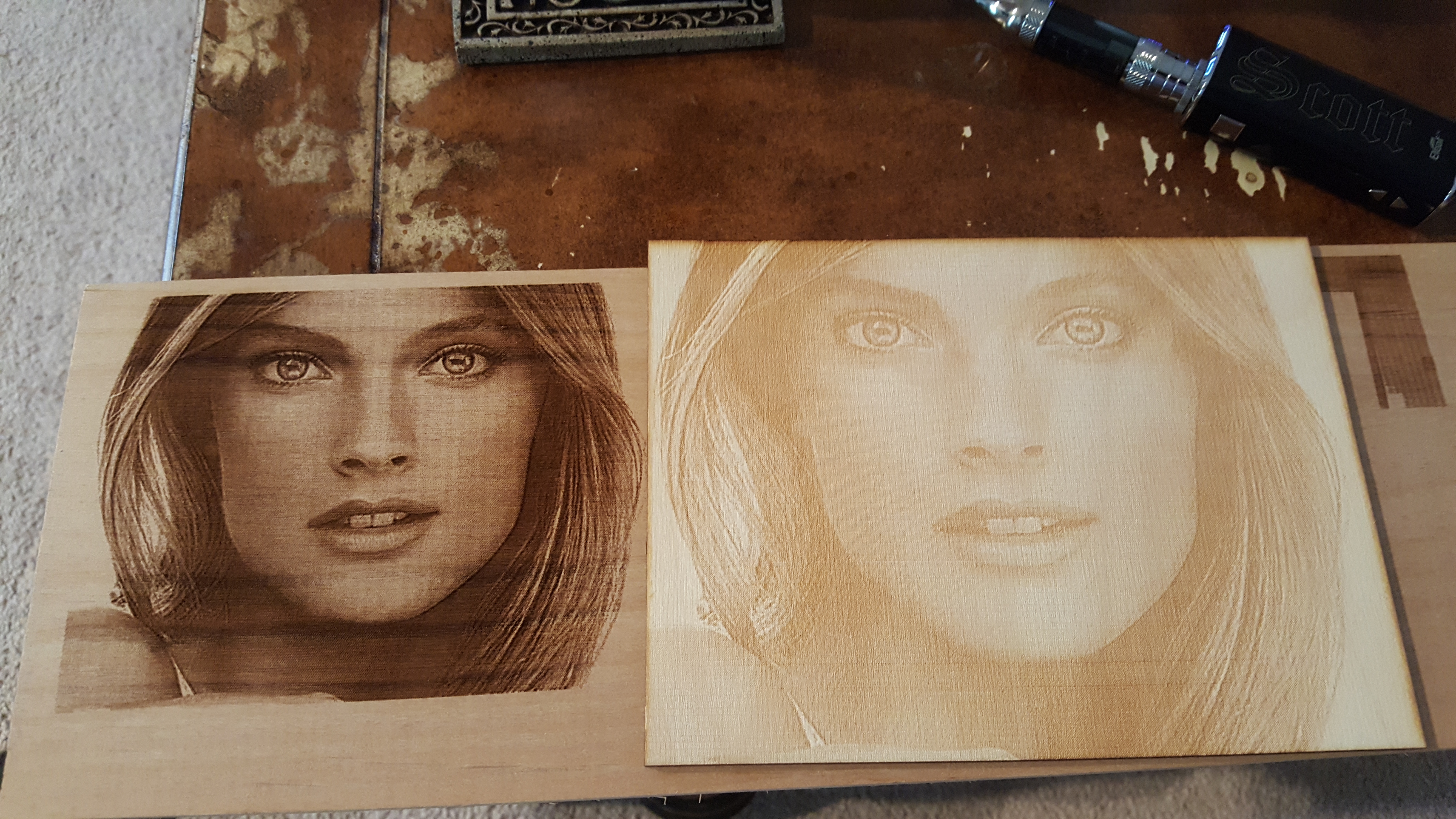

For those that think the type of wood you raster on don’t make a big difference…news flash! The left raster is done on alder wood cooking planks sold on Amazon.com. for 20 bucks…the raster on the right is Baltic birch plywood…40 sheets 12x12 for 35 bucks…do the math!

WOW nice detail!
Is that a dithered image? Or does your unit support PWM
@Alex_Krause …it’s dithered…same settings with both types of wood.
@Scott_Thorne can you post settings please, I want to approximate
Quite a big difference between the two. I’m looking into various different species of hardwood decking lately. Will be doing some tests once I get the wood (have to wait til local supplier has a big enough order from the manufacturer to add my small quantities onto it).

@Ariel_Yahni_UniKpty …power 35%…speed is 300mm/s
@Allready_Gone …photoshop
