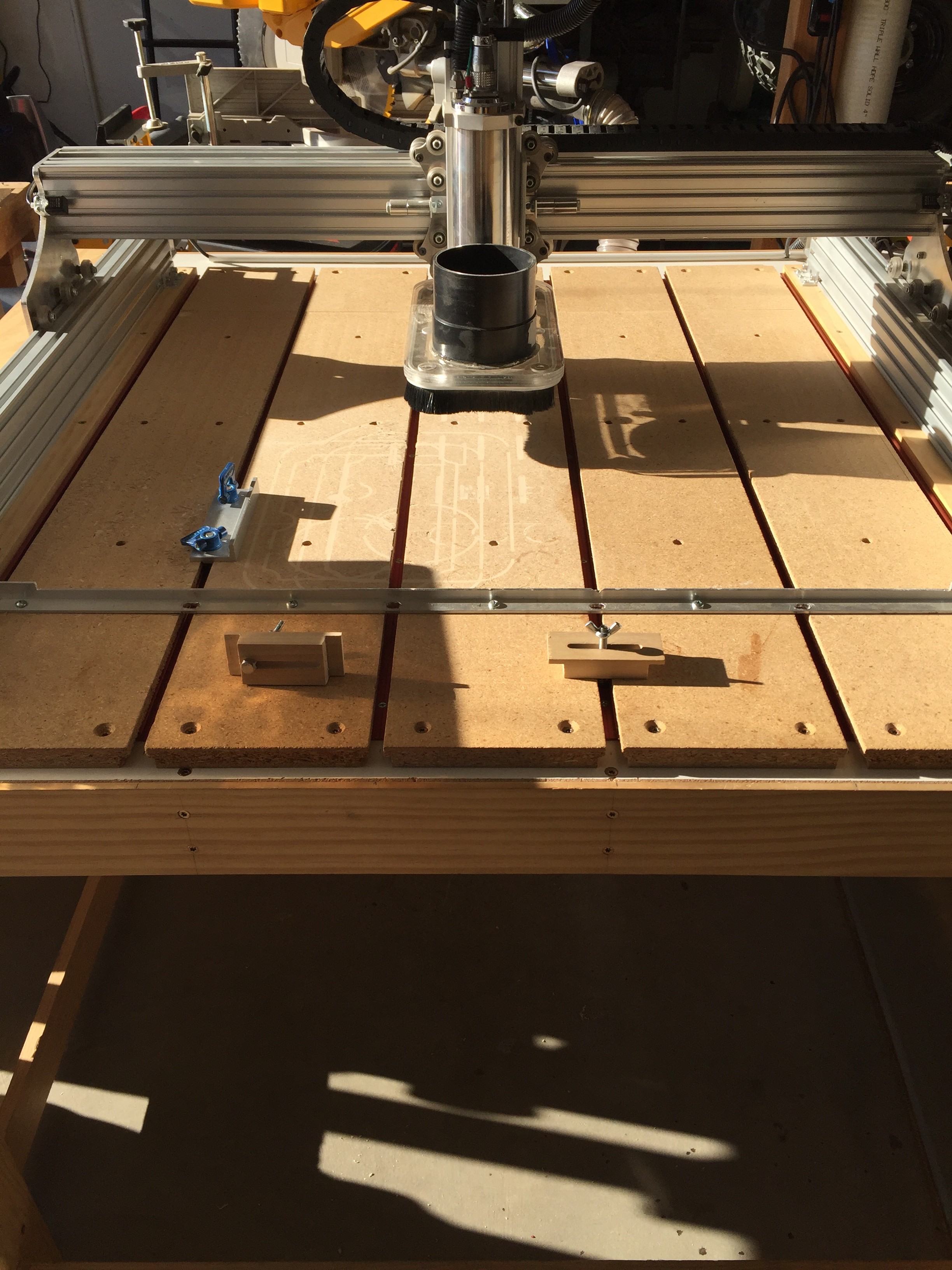

I use these home made low profile hold down clamps. My spoiler board has tee tracks I like these clamps the best as It allows my vacuum system to pass over them with room to spare. I found these clamps on you tube but with no drawings or dimensions. I think I have a cut out g code from Vcarve.
Thanks. I do think that I will install some type of t track in the spoiler board.
