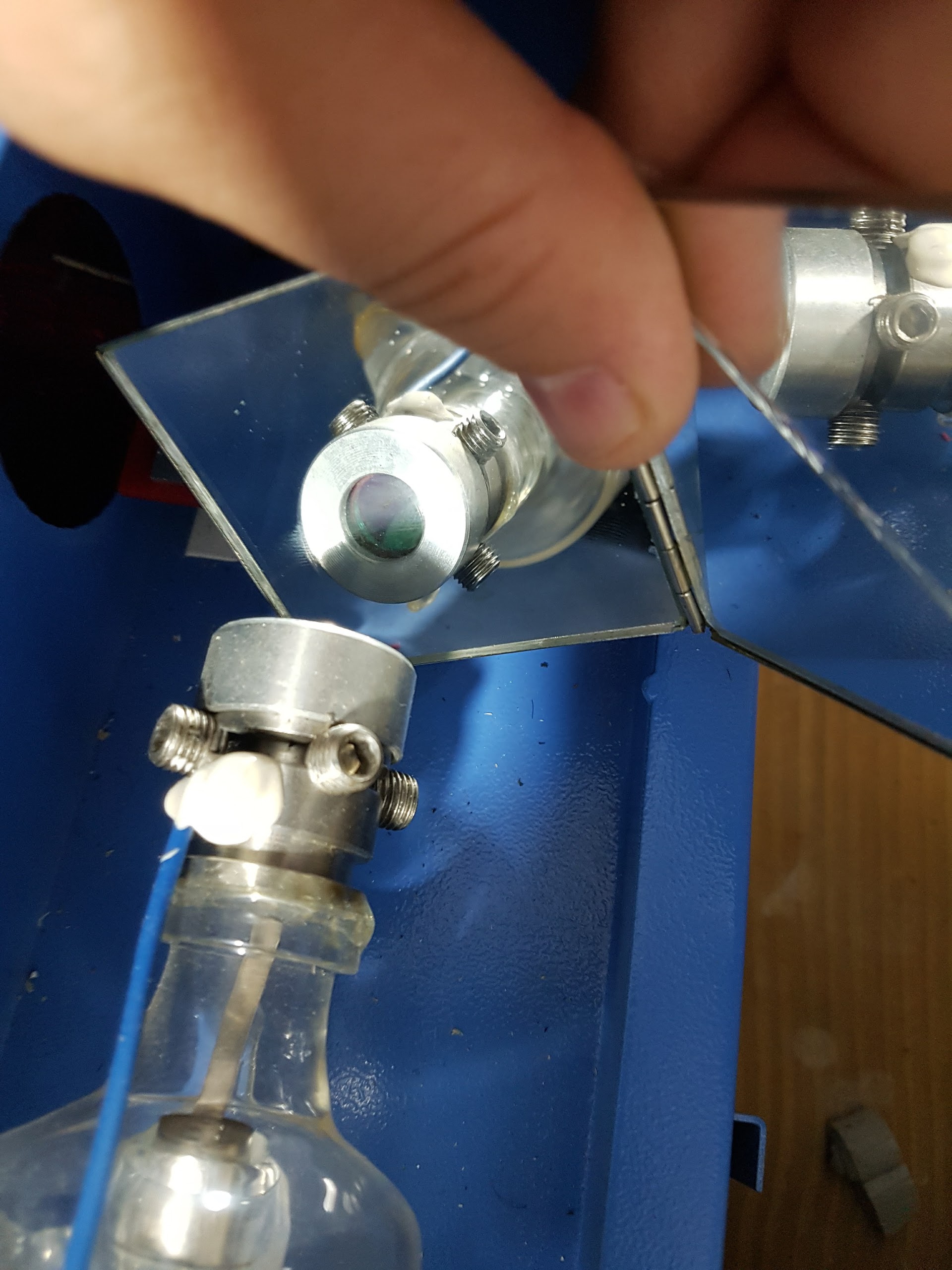

For those who followed my issue with the tube here https://plus.google.com/+ArielYahni/posts/SzYi69n17pd I took some pictures of how the tube lens was before cleaning, I would say it was a little dirty but not.So much did. Nevertheless after cleaning no beam coming from it
That’s interesting the head on it. Is it removable with those grub screws?
I think someone else suggested the other mirror (I think on the other end of tube?) may have been burned through. I’ve never really taken a good look at my tube, so not really sure how they work.
Could be removable, not sure I want to touch it :frowning:
@Ariel_Yahni_UniKpty I’d be feeling the same. Almost certain if I removed something like that it would be broken afterwards.
Am I right that you said the tube ionizes and draws current?
Has to be something wrong with the internal mirrors, warped or broken.
Any unusual thermal shock before this?
The both mirrors (front and back) of a laser tube was adjusted very accurately during production. Thats what the grub screws are for. There will not be a beam emited or just very low power, if they are not absolutely parallel.
If your tube stopped emiting a beam whithout disajusting the head (by mechanical hit or something), then probably the mirrors are burned inside caused by overheating. In this case no chance to get it back.
But if you hit the head, there is a chance to readjust it to get operation back. But that’s probably a job for a pro (with pro equipement).

I have never seen a k40 tube with metal adjustable heads! where did you get it from?
Could you take more photos of the tube?

Its an interesting design as normally the cheaper tubes are all glass and the metal ended ones do not start until around 80 to 100w
Although this design is odd because it looks like you still had to silicone it? No screw terminal?
Also the set screws 1 not many to provide real adjustments and 2 don’t look like they are locked in place :o
