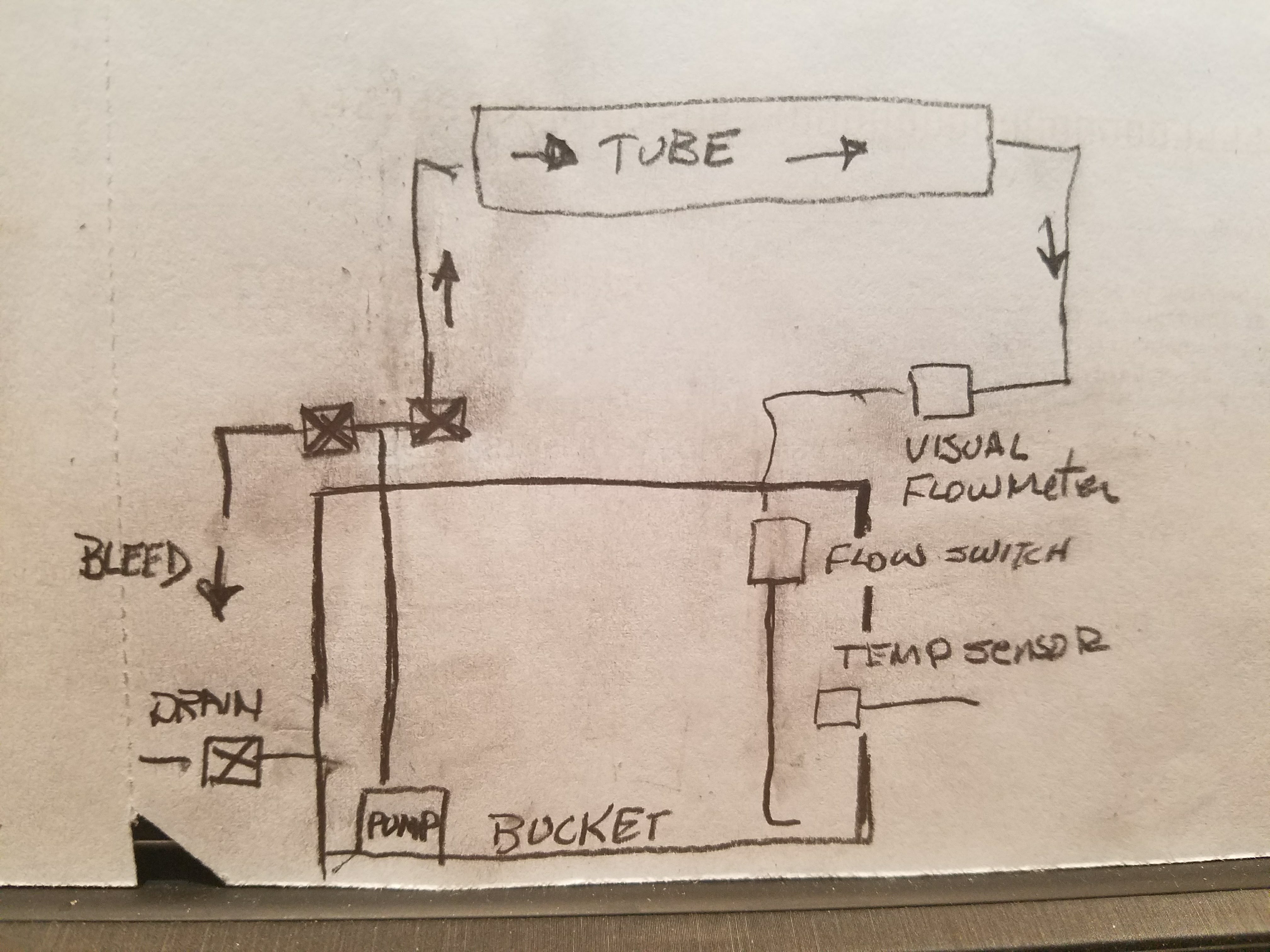

I am now thinking of ways to use valves to close the tubes water loop while changing the water and then bleeding the lines before opening them up after the exchange? This would be used after you once get the bubbles out by tilting.
Then again as I look at this drawing, maybe the simple approach is to have a drain valve in the bucket just above the pumps water level so that the tank can be drained yet the cooling loop is never broken. The disadvantage is that not all the water is replaced with a exchange but I think that small amount would not be a problem? I like this idea because it allows the tank to be drained without pulling it out from below the machine. It would also facilitate having a larger reservoir for more cooling capacity.
Once the bubbles are eliminated, the best way to keep air or bubbles out of the system is to clamp the lines. I was using hemostats to clamp first the outlet and then the inlet tube while the pump was still running. Brass valves would be a better option in the long run.
When I was in college I worked in a pet store and was also an aquarium hobbyist. They make valved quick disconnects for things like under the cabinet canister filters so you can clean out the filter without siphoning out the tank. Like this https://www.amazon.com/Marineland-Magnum-Disconnect-Double-PA0586/dp/B0002APYNQ
Hmmm now that I think about it you might still get some air from the disconnect space when reattaching. Bubble trap right before the tube inlet perhaps?
@Nedman … that is why I was thinking of bleeding or never let the loop go dry.
