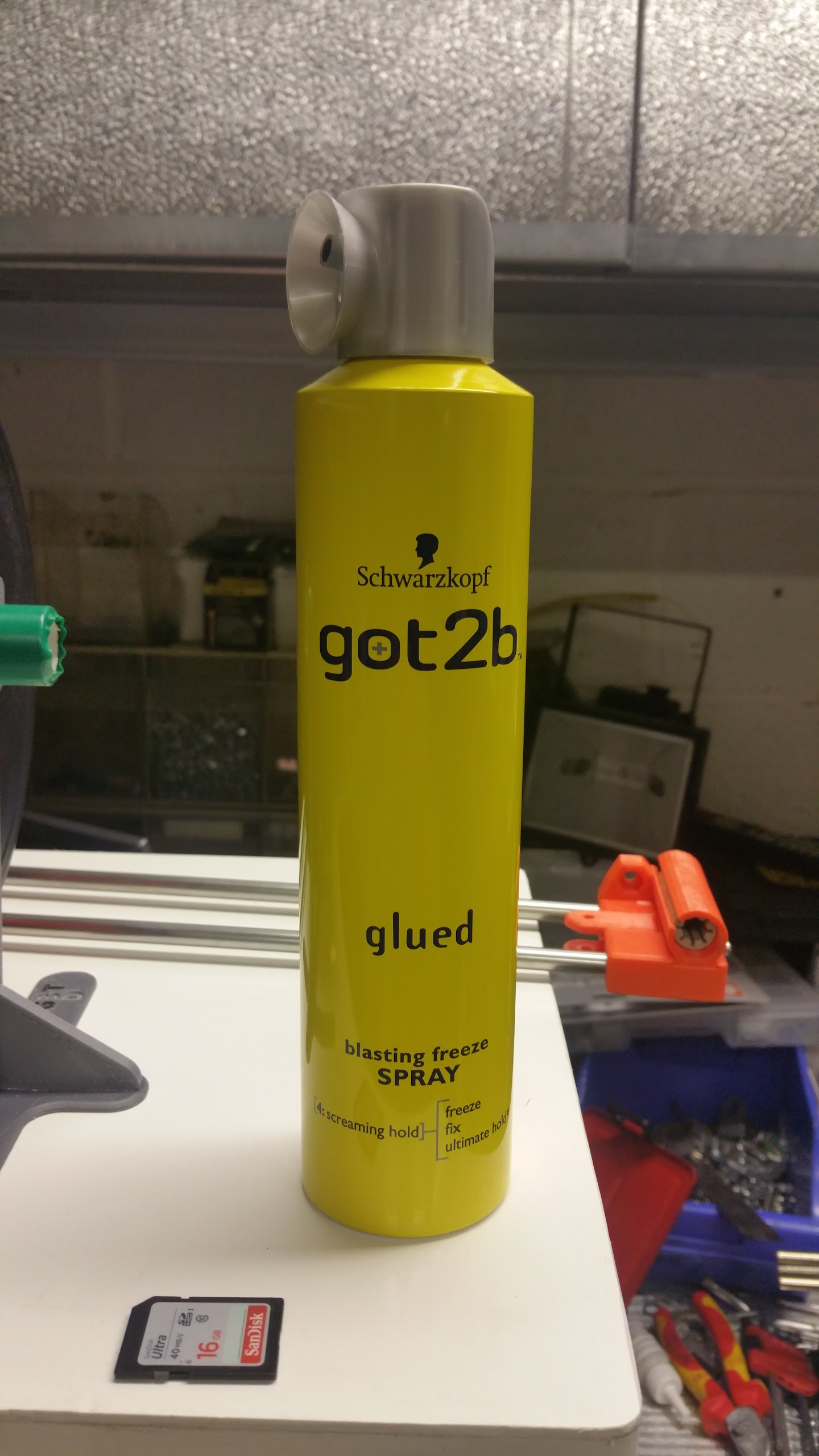

For those who use hair spray to stick prints to the bed, I have tried many and this is the best so far. Not had a single lift yet. It’s like s**t to a blanket

Found some of this fairly cheap, so decided to sate my curiosity. Usual thick application, baked on. Tried printing a large area print in PETG and each time it warped or came loose. I’ll stick to Insette…
