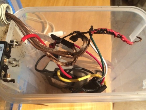

For your Sunday evening amusement, and as an explanation of why I’m not particularly keen on powering my wearable projects with exciting lithium chemistry:
You’ve got my attention.
Nothing in that article says they were using Lithium batteries. It was an SLA that got shorted. Any battery that gets shorted will cause some sort of (serious) failure, not just Lithium. It’s the end-user’s job to learn how to properly handle the type of battery they’re using. Proper insulation is only one of many steps.
So a series of planning, execution and decision items were poorly implemented and lithium batteries are the work of satan.
OK, gotcha
I was implying that if I can create this much havoc with lead acid (that had the grace not to explode with its terminals shorted) then imagine what fun I could have with lithium!

I’ve updated the post above with a pic of the Beetle that was supposed to be powering it. Poor little bugger didn’t stand a chance…
