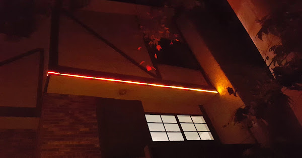

I’m happy to report that all that was needed was to not run the LEDs at full 255 brightness. I dropped them down by 50%, which seems plenty bright. I’m assuming the amperage draw was just too much for the 2.5a power supply I’m using. I can now focus on pattern and palette design without stressing over the physical components. Thanks for the help!
(the colors are poop on this video, but you can see the pattern is shifting across the entire strip)
Are you feeding power from more than just one end?
No. If I were using more strips I would start considering it, but it’s not something I’ve ever done before. This is the largest set of LEDs I’ve used. Normally, I would say it’s something I’ll consider doing later, but I’m not keen on renting another ladder and getting up there to do it.
I’d try a quick test by adding power to the end of the strip as well. The results you describe can occur if the LEDs aren’t getting enough power. Five meters is a long way to go – the strip will create its own resistance. In fact, if I was doing a permanent 5-meter installation, I’d connect power at least to both ends and in the middle.
Then again… if you’re happy with 1/4 brightness… no change needed! :slight_smile:
It’s at half bright and looks pretty good I think. If it really were a quick test, I’d give it a shot, but like I said, wiring up the end would mean renting a ladder to climb up to them with a soldering iron, heat shrink, heat gun etc . . . Just way too much of a hassle.
