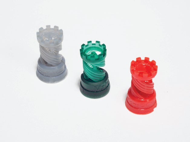

I made a thing for you @Thomas_Sanladerer here: http://www.thingiverse.com/thing:455584

Thomas, any chance you can share the stl file you used for the test?
@Simon_Villalobos sorry, the file was given to me by Formlabs under the condition that i don’t reshare it. However, they are considering making it publicly available at some time.

If you want to give people the twisted rook file give them this link!
