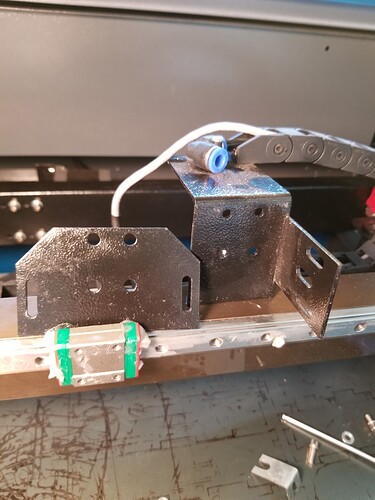

This is the bearing (head) and the hardware that holds the drag chain to the head. The ‘bend’ protruding forward was where the head was attached on the right. No Z adjustment.

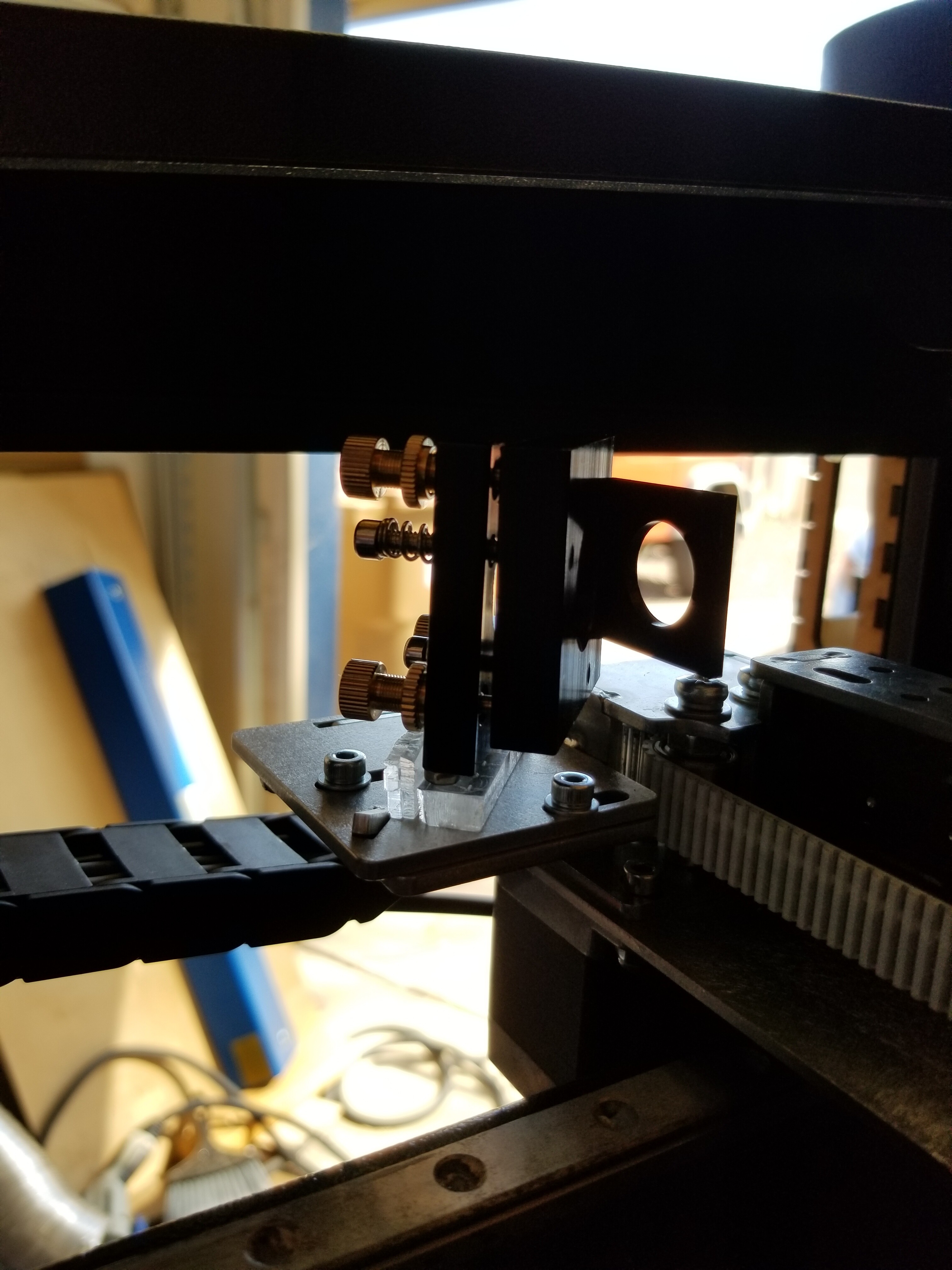

It’s one of Russ’s ‘rack & pinion’ drives… There is also his tube/m1 holder… Sticks out the end now… 3d printed a cover.
Tube mount…
