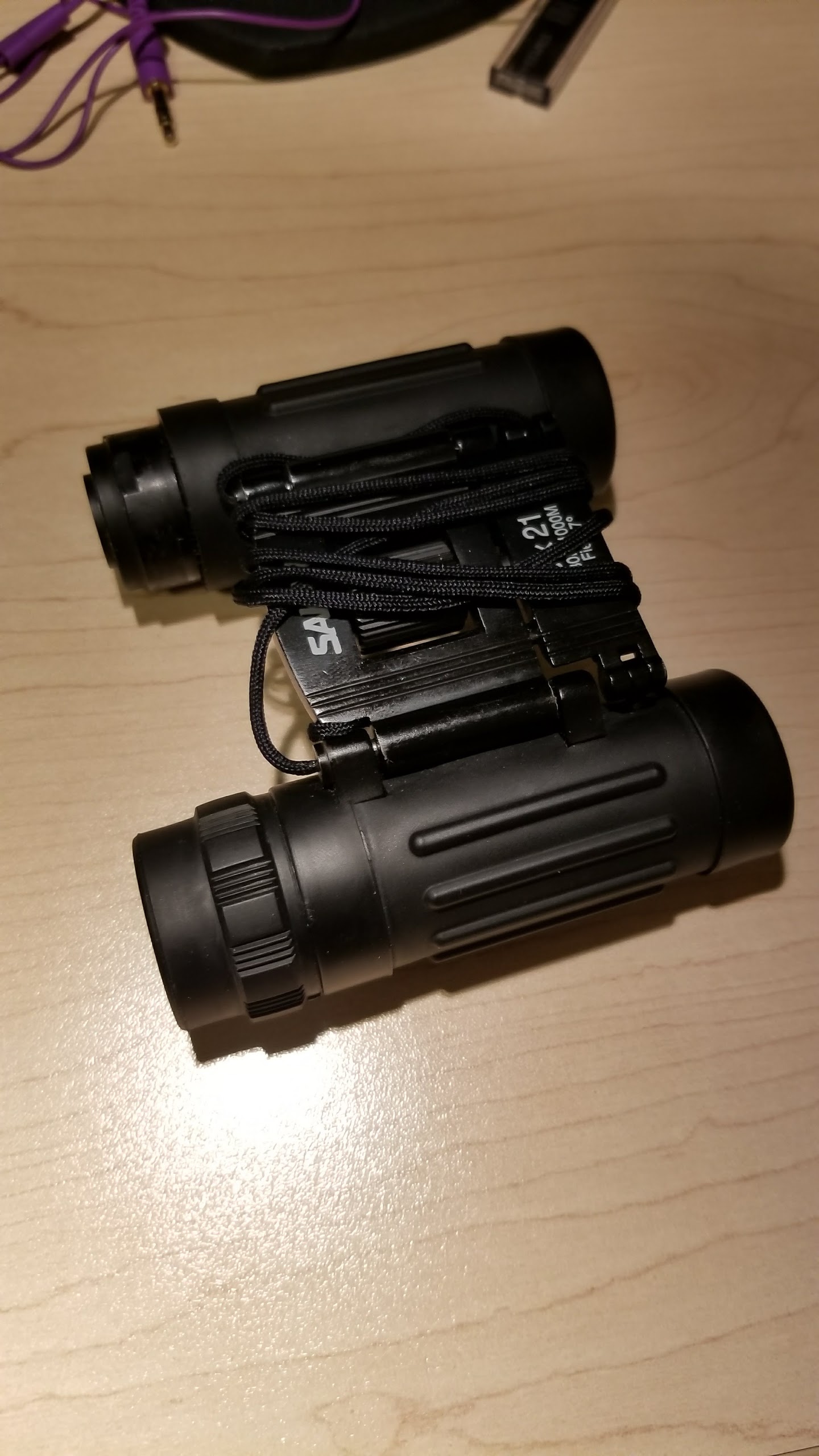

Found old binoculars, with one rubber eye piece missing
Found old binoculars, with one rubber eye piece missing. Since I do not have rubber filament, I decided to replace missing piece with PLA printed. After 15 minutes in Fusion 360, I had a model ready for printing. Since I was trying to get away from support structures, I had to split the piece into two parts with threaded connection between them.
Loaded the design into Prusa i3 MK3 with black PLA filament and in 30 minutes it was ready.
I was very pleasantly surprised when I found that the threads were perfectly printed and screwed one into other without any issues.
Total time from start to finish - one hour.

@Slobber_bone This is individual for every binocular. STL file will not help in your case. You need to create design in Fusion 360 (or any other 3D design app) according to your particular model
