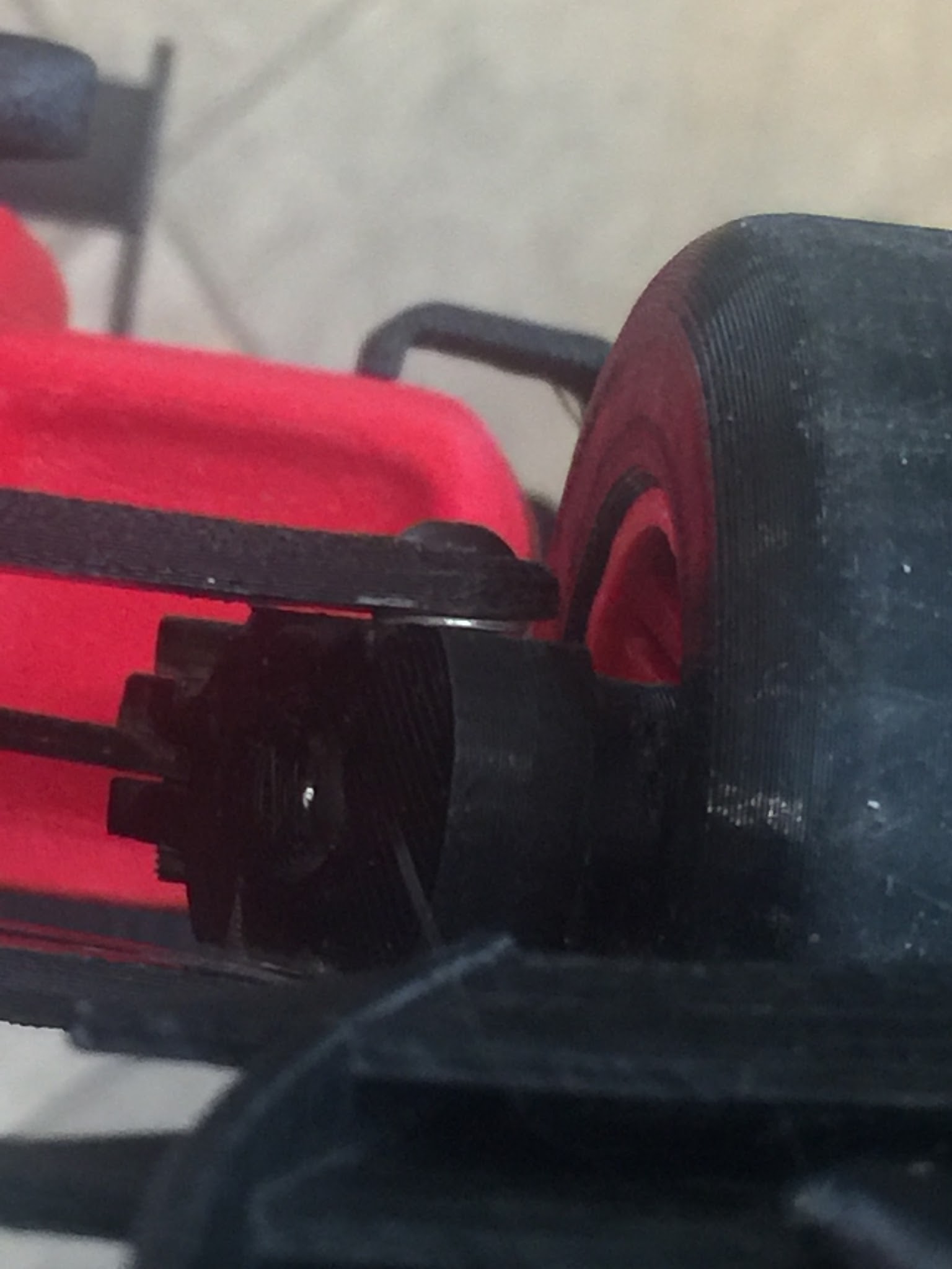

Four 3mm washers for the tops and bottoms of the axle holders can reduce the friction between the upper and lower suspension and the axle holder, to make the steering a little smoother.
If I had nylon washers in that size I’d use them instead.
