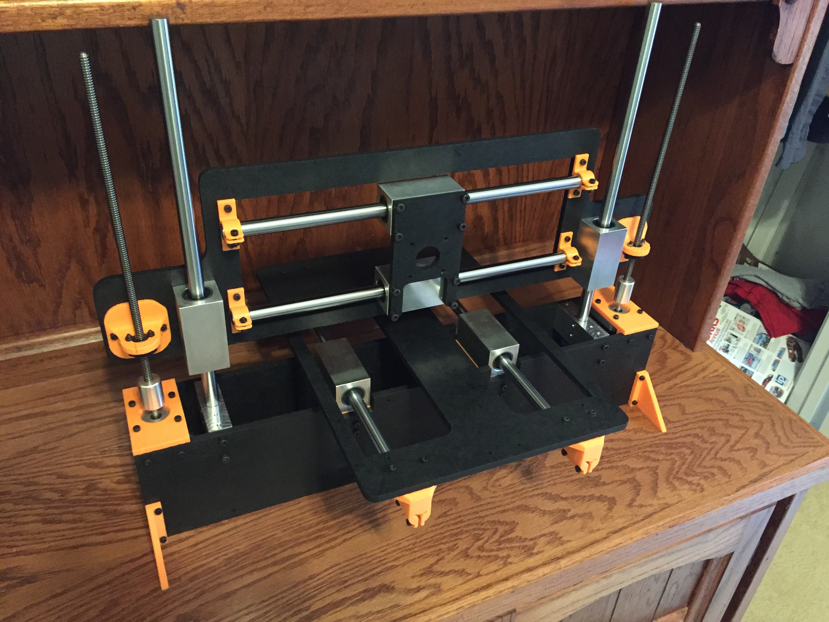

Franken-bot update: The whole frame in terms of mechanicals is now finished.
Franken-bot update:
The whole frame in terms of mechanicals is now finished. I still have to mount the belts, motors, extruder, and endstops of which I will be working on this week.
But here is the (almost) final product!! The feet are going to be changed and the rod mounts for the y axis are going to be switched for some similar to that of the bed’s. I also anticipated a slightly smaller build width so I will be widening the bed by about 25mm to add some build area. The build size is about 210x240x200

Hahahaha that is excellent @Mike_Miller !! The beefiness makes it sooooooo stiff!

It looks like the bigger brother of the OneUp machine. :slight_smile: without the weaknesses!
The 1up used my open source ideas on the original Printrbot and simple makers kit - and did a poor version of the Ubis hotend (not open sourced) to make theirs… They took some short cuts that make it inferior.
The frankenbot here ends up much closer to the old Printrbot plus but with some neat printed parts for maker-friendly builders. I’m stoked when anyone uses my ideas and executed well like he did!!

Brook is right. I undoubtedly looked at the printrbot plus for reference. But I’m not one for stealing everything from a design and slapping my branding on it. In the end I knew the design was solid and I saw some things like backbone bracing and went to incorporate it.
In the end it’s innovation of ideas and designs that moves stuff along. These parts were from a plus more or less completely so why not try to make something similar.
