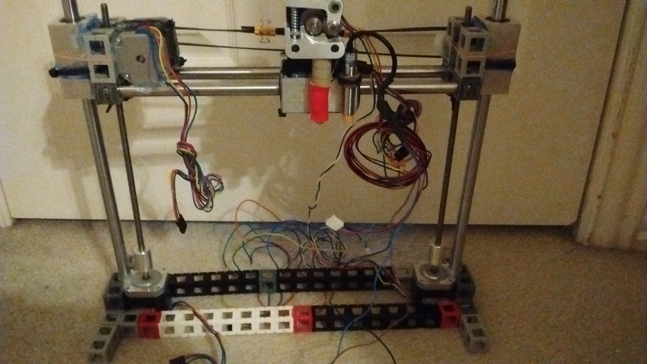

Frankenbot/Repstrap update I got the y and z axis together, very hacky,
I got the y and z axis together, very hacky, but it should work.
To power the printrboard, I will use a PC power supply, but some of the ones I have as soon as you turn them on, they shut off, ( green and black wires are shorted to turn it on) any ideas on how to get them to stay on?
Picture’s are attached
Oh lordie, the crookedness of that X belt run. Please tell me it looks better in person?
@Ryan_Carlyle it’s better in person, but I need to get it tighter for it to work properly.
