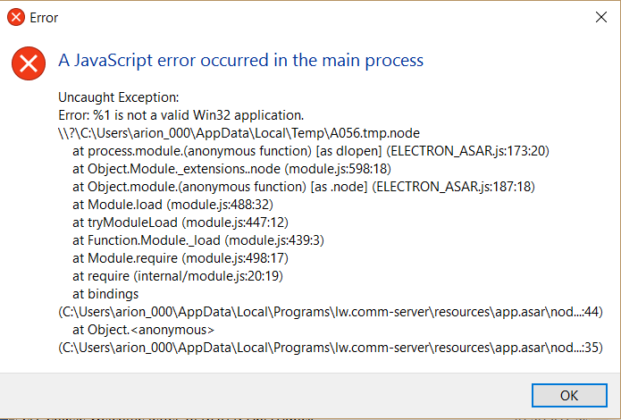

@Jorge_Robles When I update to this version, I get the error in the screenshot. When I revert back to an earlier version, LW works fine… Is there something wrong? I am downloading the “LaserWeb.Setup.4.0.68-729_x64.exe” installer. 728 works fine as well as a previous version I had.
Going to recompile
@Arion_McCartney please try win32 build. Are you using a 32 or 64
win?
I am using 64. I tried 32 a bit ago and got the same error.
Should I try downloading it again?
Let me recompile. Will post. Thanks!
Ok great. Thank you!!

Done… Please download from https://github.com/LaserWeb/LaserWeb4-Binaries/releases/tag/v4.0.729-68
@Jorge_Robles It works great now. THANK YOU!
