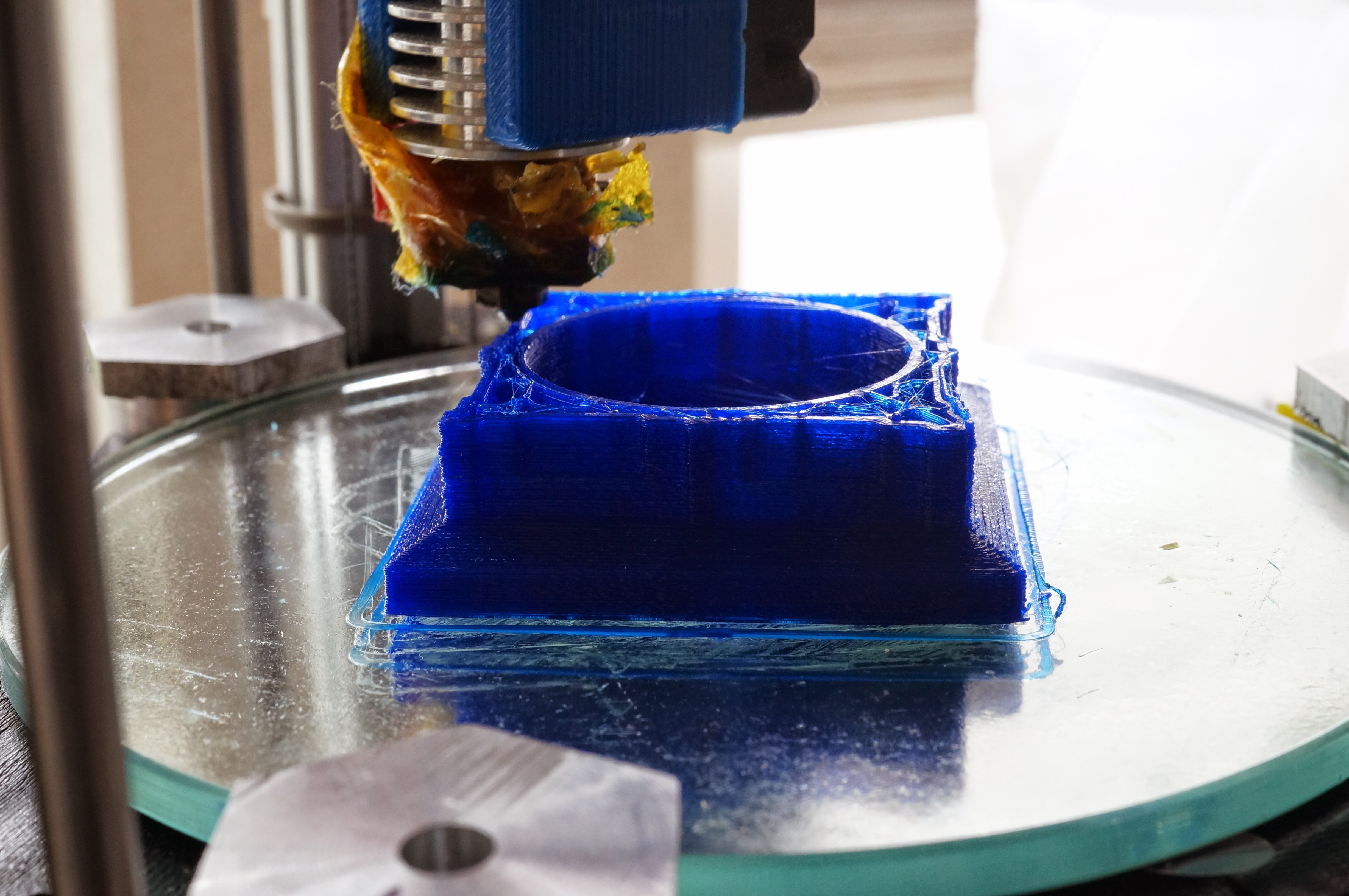

One thing I noticed, and was easy to miss when looking at other variables in printing, was just how ‘wet’ fresh PLA looks when it’s printing. The layers just FEEL like it’s going to be a successful print, regardless of how long it will end up taking.
I tried capturing that in a picture and about all I can say is: look at the shine on the plastic on the right-hand side…that’s a good strong layer.
I’ll also add that it’s pass 1 of three, you can see the circle in the middle that three passes make a solid, thick, wall.

@Mike_Miller I have noticed through the years that surface shine, for me, related to temp. I can make a dull “smooth” looking surface, or I can make a hard looking shiny surface. This only applies to PLA, but for me if I burn hot I get shiny, cold is dull.
@Brandon_Satterfield This one’s running at 200…I might be able to dip as low as 190, but 180 is a guaranteed failure.
@Mike_Miller agreed, I have had one I can burn at 180. It was a generic white PLA. My ( don’t shoot me it was heavily discounted 6 mo ago ) makerbot blue 1.75 PLA will be dull at 186 and shine like crazy at 205. I have tried this with yellow, red, purple, and green to get the same results. Although, temps vary for each.
