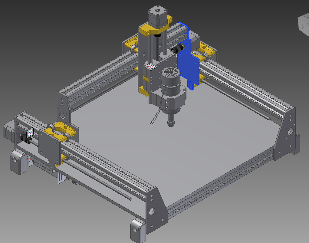

From CAD Design to reality. Bed need to be changed for a smooth and level surface. 3D printed parts for X axis, need to be reinforced. Uses Arduino Uno and protoneer 3.0 board. Screws of Y Axis need more pitch for faster movements. Need Stepper motors with more torque for aluminum milling.

The easiest way to get a flat bed is to use a wide levelling bit on the router - like this one: http://www.aliexpress.com/item/1PC-X-High-Quality-shaped-CNC-Router-Bottom-Cleaning-Router-Woodworking-Bits-SHK-1-2-12/2023624577.html
It also allows regular cleaning of your sacrificial bed back to a level plane.
