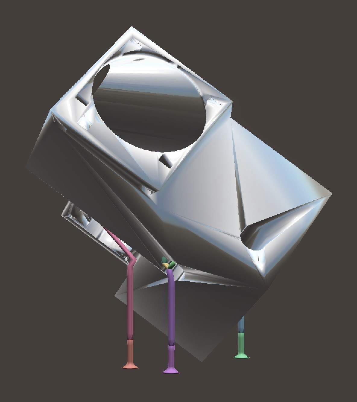

-I don’t print ABS because I don’t have a heated bed.
-I had a few successful prints using blue tape + Superglue to get adhesion but the fumes were NASTY.
-Meshmixer lets you reorient your part, sometimes in wierd and unusual ways.
So use Meshmixer to tilt your part so that it only touched the build plate in a few small places. Ensure initial layer adhesion (currently a problem for me…the part contacts the bed in 4 places…currently has a 75% success rate. :slight_smile: )
The ideal rotation in this case is 45 degrees on one axis, then 35 degrees on the other, but you need much more aggressive support to keep it from being knocked over while printing.
The office on the main floor of the house is an enclosed chamber. :slight_smile:
@Whosa_whatsis I’m discovering that. And the corner of the print needs a pad as well.
pva (elmers glue stick.) makes abs stick as good or better than ABS slurry in most cases, without the fumes. A 30 pack is super cheap on amazon (elmers)
