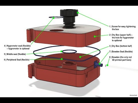

There are filement boxes already (like nice Spannerhands’ Spool System, SPANNERHANDS Spool System Wall Mounted Spool Holder & Dust Cover by 3DMasterRace - Thingiverse), but all of them demand quite a few non 3D printed parts. I have started designing in Fusion 360 from scratch with the old RepRap approach (“we can 3D print almost anything”) to change that… And here is a result after several small iterations.
Tom's Fully Printable Filament Box V2 with (optional) Hygrometer by tomulinek - Thingiverse
PS: Maximum part sizes are 210×210mm so even users with Prusa i3 MK2/3 will be satisfied (I hope). Printers with bigger print volumes (like Ultimaker S5) are plus as there are no artifacts along the tight printing bed limits.

I like the reprap philosophy in it, it looks good and is not adding much bulk to the size of the spool. If I were to suggest anything it would be to make it stackable - right now the screw stands in the way of a compact stack (ex for a full shelf of rolls).
@Florian_Ford Thank you. It’s intended for temporary use in workshop during 3D printing sessions (hanging on the wall above direct drive machines or sitting behind the bowden printers) as it can’t be watertight enough to be a long-term storage (and it’s quite demanding to be). The material of shell absorbs humidity itself, printed seals are not 100% smooth, so it can not be as good as watertight bag or filament boxes made from stabilized and homogeneous materials (Polybox etc). But I still found it useful. :wink:
It depends how fast are you running through the roll :slight_smile: … if it’s days then it’s ok. Otherwise a sealant coat would make it long-term.
