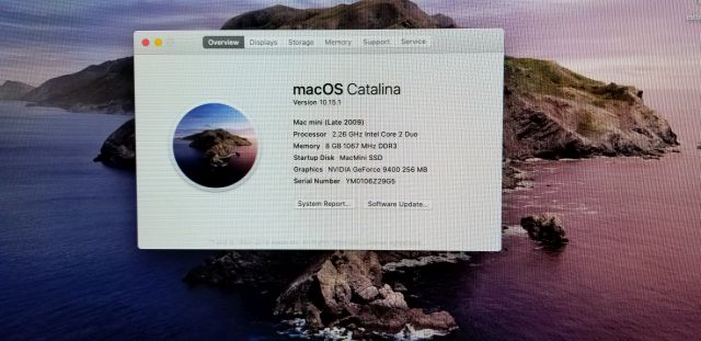

Well after trying to reinstall El Capitan without any real luck, I decided to see if Catalina would install.
There is a program that allows you to install a newer OS than what Apple thinks your system can handle.
Here are the results! It runs like a dream!

@StephaneBUISSON It was more proof of concept and I wanted to see if there was a hit to the performance of the hardware which there was none that I could tell. I am still on the fence about what I am going to use the Mini for and therefore not sure what OS I will finally use.
