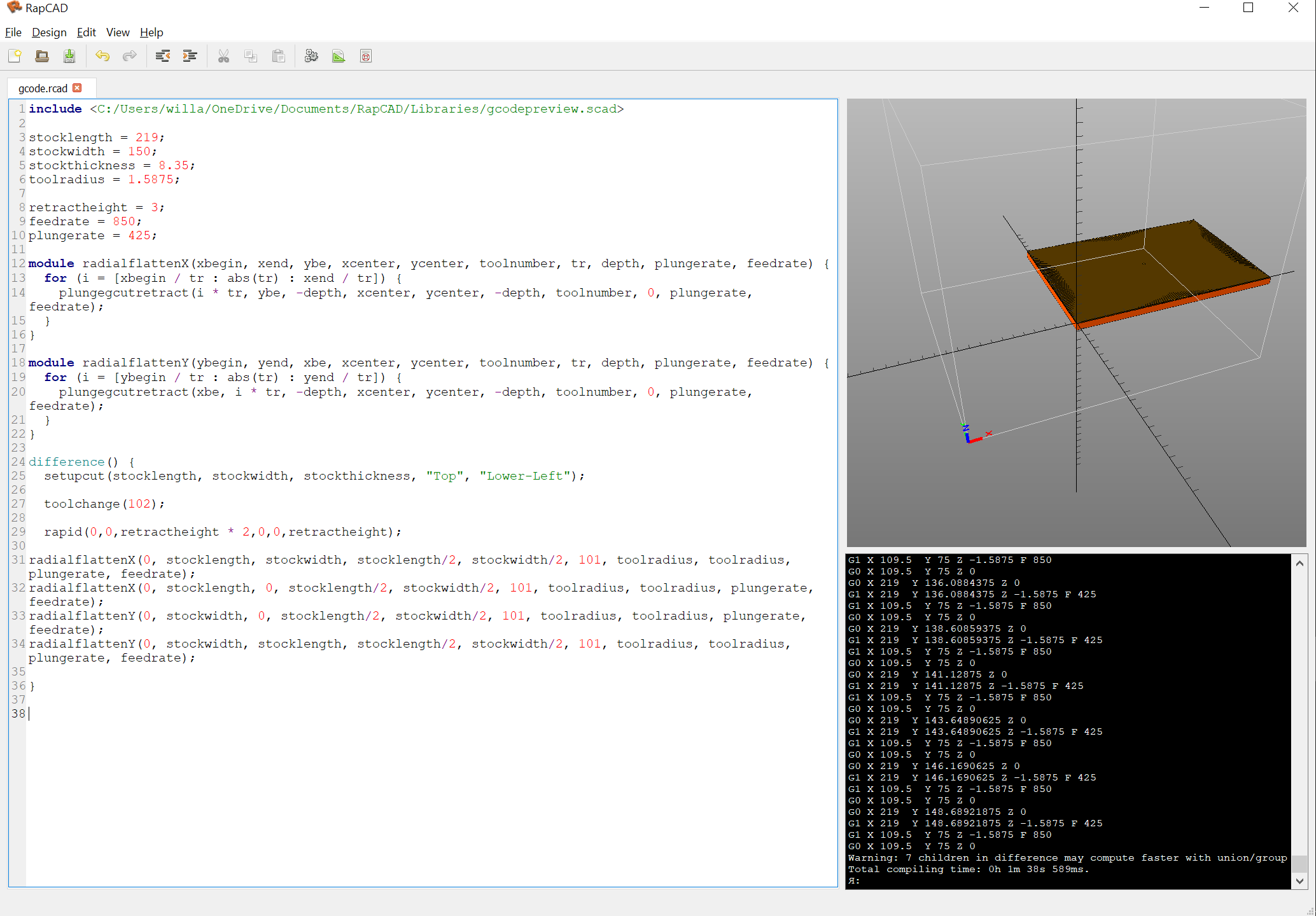

After adding/adjusting modules (updated at: gcodepreview/gcodepreviewing.scad at main · WillAdams/gcodepreview · GitHub )
we can make a file like to:
include <C:/Users/willa/OneDrive/Documents/RapCAD/Libraries/gcodepreview.scad>
stocklength = 219;
stockwidth = 150;
stockthickness = 8.35;
toolradius = 1.5875;
retractheight = 3;
feedrate = 850;
plungerate = 425;

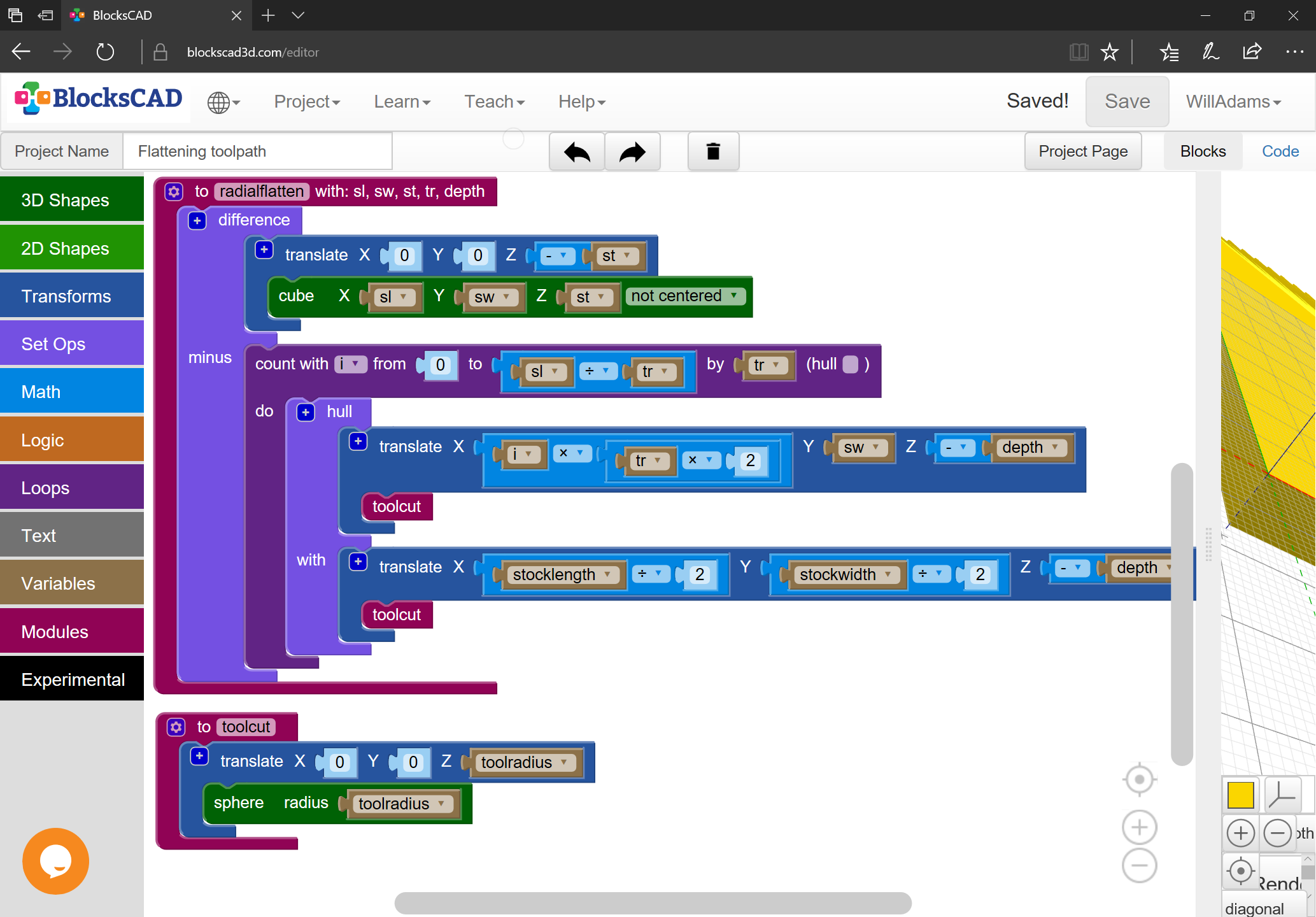

module radialflattenX(xbegin, xend, ybe, xcenter, ycenter, toolnumber, tr, depth, retract, plungerate, feedrate) {
  for (i = [xbegin / tr : abs(tr) : xend / tr]) {
    plungegcutretract(i * tr, ybe, -depth, xcenter, ycenter, -depth, toolnumber, retract, plungerate, feedrate);
module radialflattenY(ybegin, yend, xbe, xcenter, ycenter, toolnumber, tr, depth, retract, plungerate, feedrate) {
  for (i = [ybegin / tr : abs(tr) : yend / tr]) {
    plungegcutretract(xbe, i * tr, -depth, xcenter, ycenter, -depth, toolnumber, retract, plungerate, feedrate);
difference() {
setupcut(stocklength, stockwidth, stockthickness, “Top”, “Lower-Left”);
  toolchange(101);
  rapid(0,0,retractheight * 2,0,0,retractheight);
radialflattenX(0, stocklength, stockwidth, stocklength/2, stockwidth/2, 101, toolradius, toolradius, retractheight, plungerate, feedrate);
radialflattenX(0, stocklength, 0, stocklength/2, stockwidth/2, 101, toolradius, toolradius, retractheight, plungerate, feedrate);
radialflattenY(0, stockwidth, 0, stocklength/2, stockwidth/2, 101, toolradius, toolradius, retractheight, plungerate, feedrate);
radialflattenY(0, stockwidth, stocklength, stocklength/2, stockwidth/2, 101, toolradius, toolradius, retractheight, plungerate, feedrate);
which renders as:
and loads into CAMotics w/o errors as:
Next is working out how to do more than one layer of cuts — I don’t think OpenSCAD/RapCAD have tools which are suited to solving for a number of internal passes, so this will probably need to be brute-forced/designed into the model.
Probably modules which model full-depth plunges in OpenSCAD (to try to limit model complexity) while outputting the necessary depth per pass iterations until one reaches a full depth of cut in G-code will work.

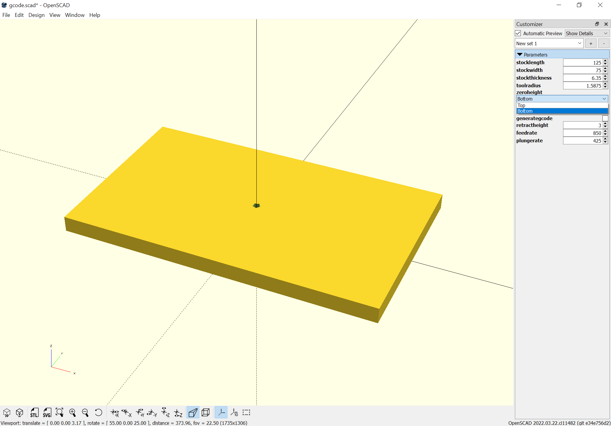

Reviewing things, the first thing is a switch for enabling/disabling G-code generation, so we add a variable:
generategcode = false;
and wrap all instances of writing out G-code in suitable tests:
if (generategcode == true) {
	writeln("G0 X",ex," Y", ey, "Z", ez);
With this in place, it is possible to disable G-code generation and use OpenSCAD for working with the file:

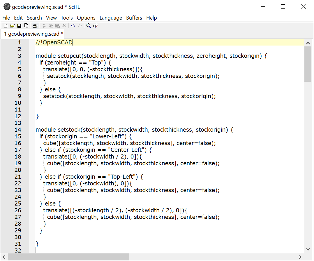

Updated things to allow all possible stock positions:
Top and Bottom:
and Lower-Left, Center-Left, Top-Left, and Center:
and when G-code is generated, there are comments which a 3D previewer can use to set the display of the stock and its position to match:

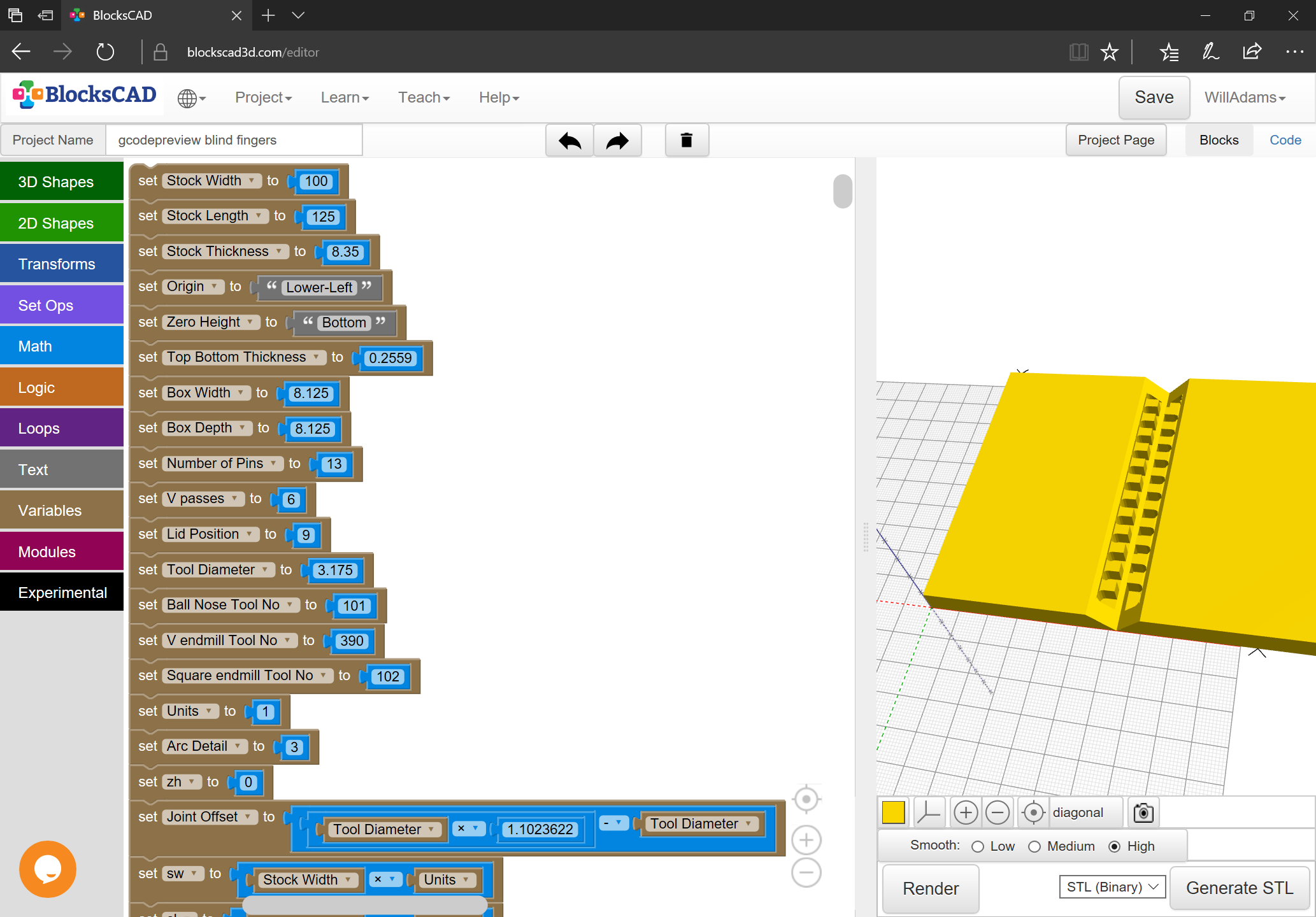

A more useful project, joinery:
https://www.blockscad3d.com/community/projects/1478465

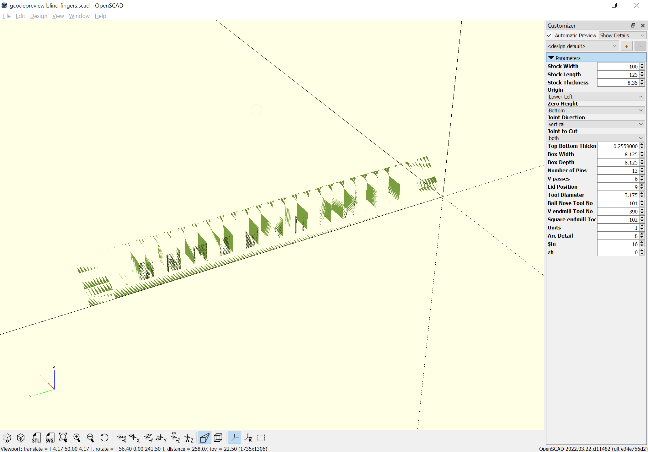

The Vertical direction is done, and one may do both, odd, or even sides:
Next up is transferring this into RapCAD so as to get G-code, then once the concept is proved out, doing the code for the horizontal option.
First, a bit of testing — had to tweak the length of the fingers so that when two pieces are assembled, and one gets the intersection of them:
there is essentially nothing — file for that here:
cncjoinery.scad (1.5 KB)

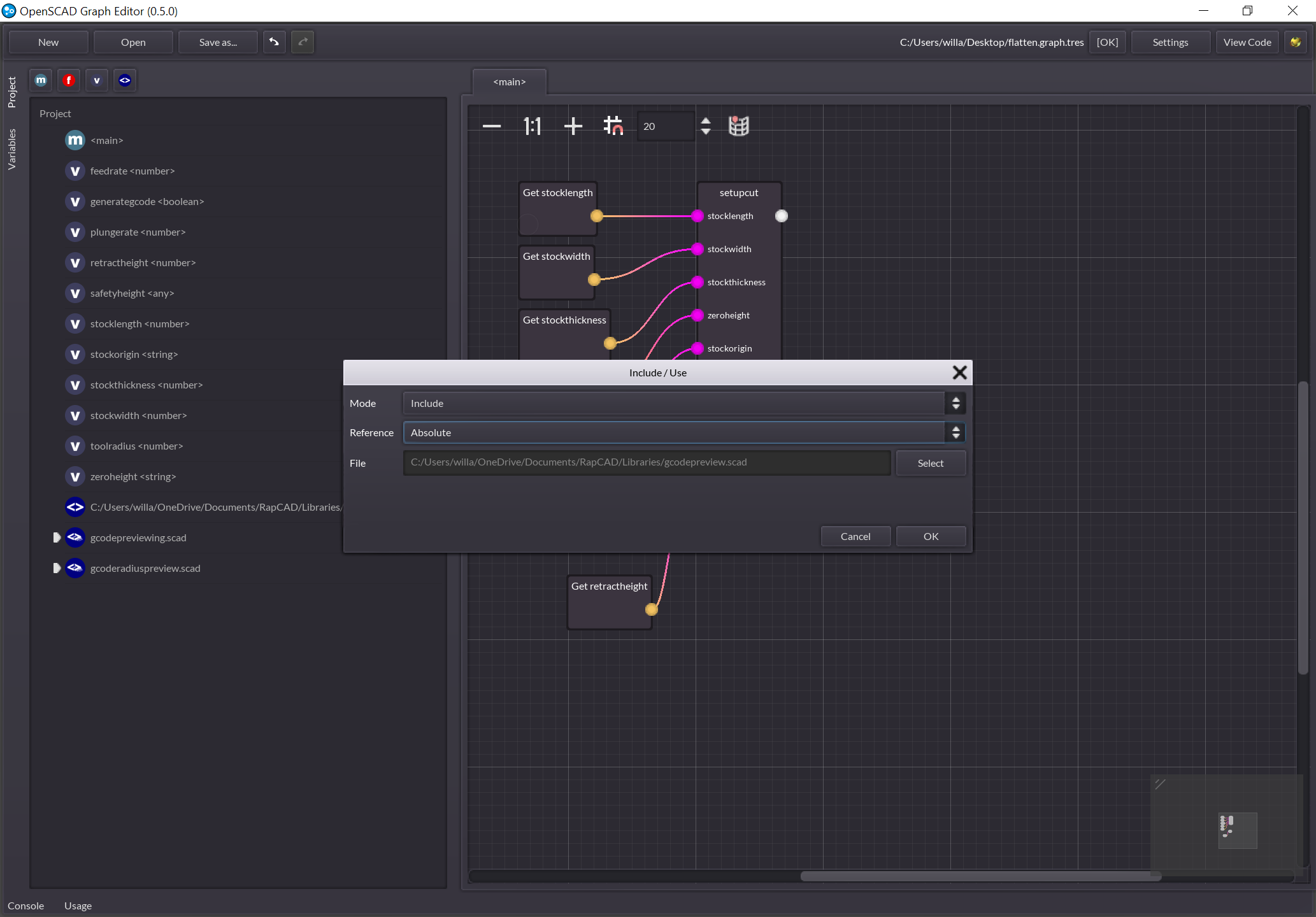

Revisiting this in OSGE:
Start by loading the gcodepreview module:
(note that the module should be "include"d rather than "use"d)
Then it is necessary to set up all of the variables which will be required:
Note that Customizer support allows one to set up drop-down menus and so forth.
