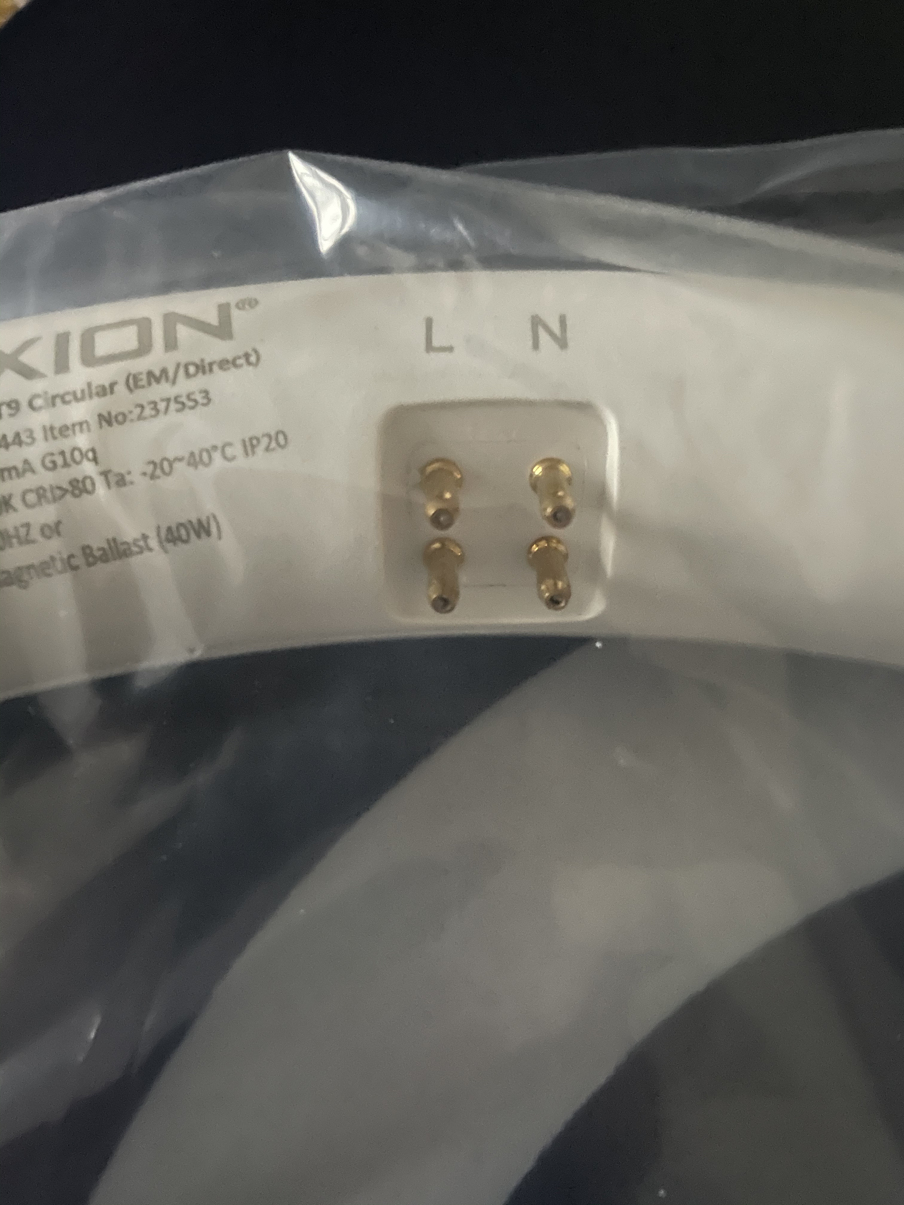

Thanks for the reply. I already have bought this led bulb with the 4pin g10q base- I thought I could swap the bulb out but apparently not!

I am pretty sure you just need to connect the mains directly to the led bulb.
You could do this by cutting the ballast off the g10q socket leaving enough wire to connect the mains. Then connect the mains to the 4 pins on the g10q connector.
The problem is that I do not know which pins are what on that LED bulb.
I would use the # above to call any-lamp and get that info.
Some research suggests that 2 pins of the 4 are neutral and 2 are hot but I do not know what pins.
Ok, great, that seems really straightforward!
L and N are marked on the bulb so I guess the 2 on the left are live and the 2 on the right are neutral
Oh my, that is the diagram I was looking for :)!
Yes the left is LINE and the right is neutral.
