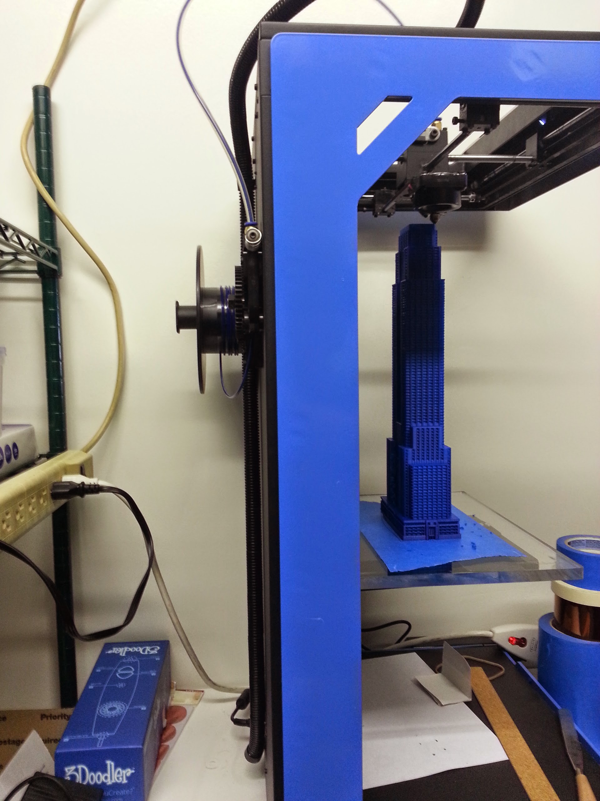

Gah.  Serves me right for not calibrating carefully...
Gah. Serves me right for not calibrating carefully… Sadly, the filament switch-over didn’t go right. :frowning:

What machine is that
I can’t see what’s wrong
@Daniel_Fielding He’s out of plastic, but the model isn’t finished.
pause + home + swap filament (if you have it) + resume = win (assuming you did not use relative commands for the gcode)
Lcd have option in tune to change filament
Well, you have a 3Doodler…
@Woody_Williams I caught that too, funny. I gotta know myself, what printer is this?
Yeah, I’m still getting familiarized with this Ideaprinter F100L. I just started it and let it keep running without looking at it, as I’m still “playing around” to get familiar with it.

I tried to manually switch out the filament, so I untensioned the drive gear – but when I tensioned it back on after the swap, I didn’t tension it back correctly, so the filament slipped and misfed.
