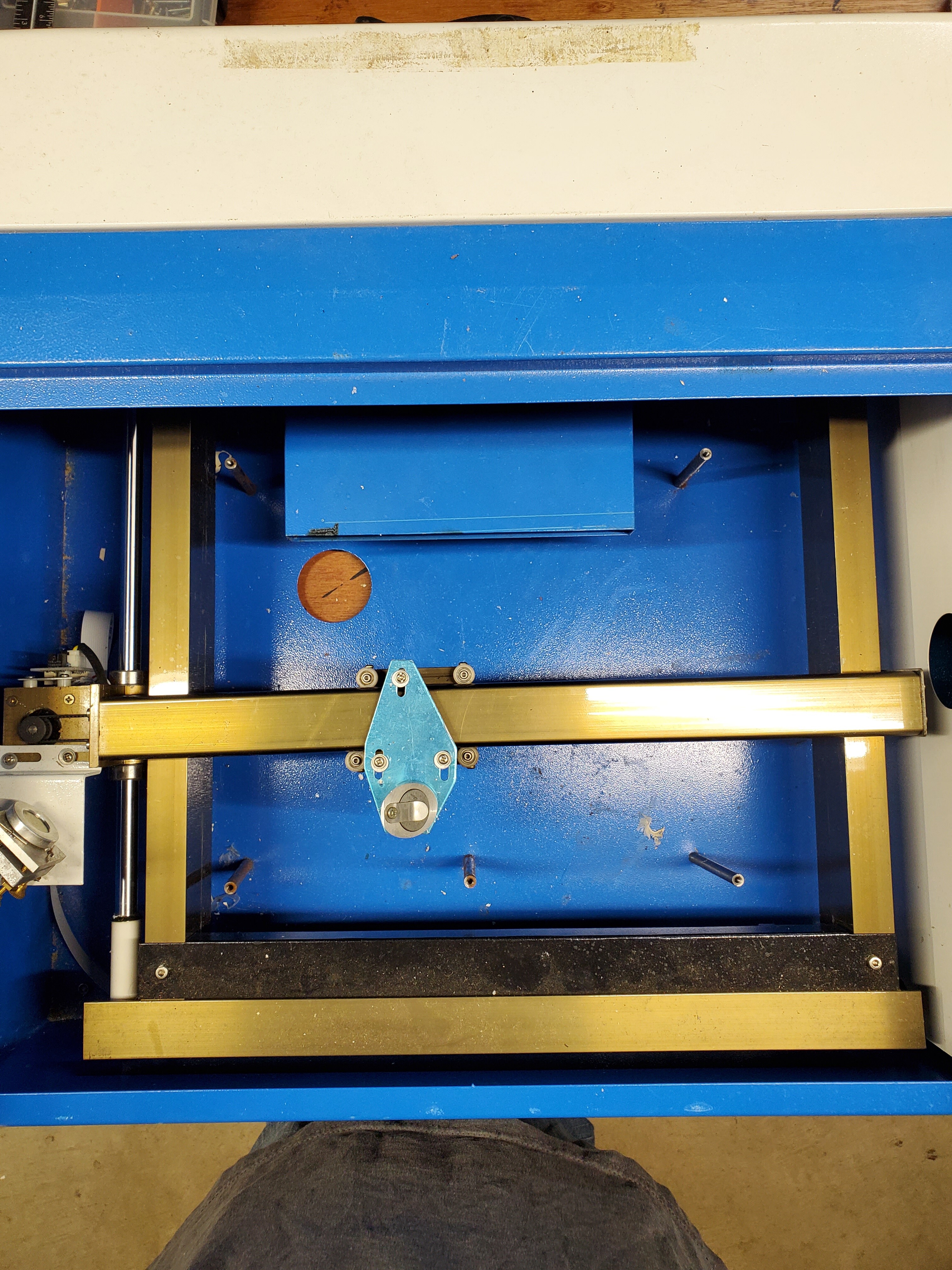

Just got a new to me K40. It needs a new tube and some TLC, but I think I still got a deal at $40.
The gantry is a bit out of whack though. How can I square this up?

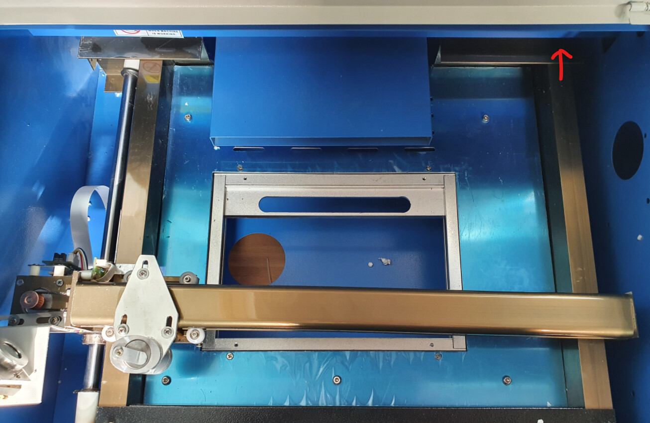

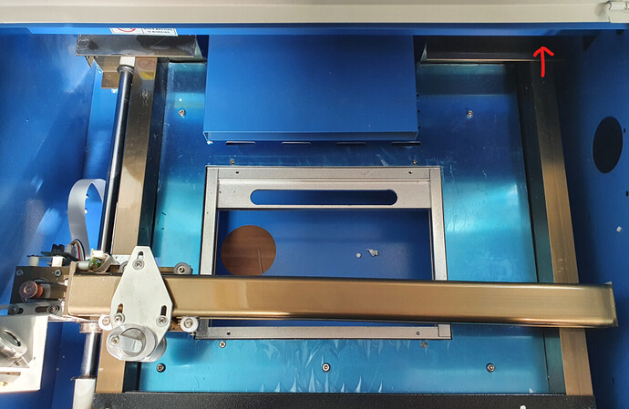

Actually here is a similar post I answered with pictures.
There is a coupler/spider in the front right. If you loosen it, you can move the left and right sides of the gantry independently.
You can remove the black L profile cover thingy in the front to make that easier. There is no real need to put it back. It’s mostly cosmetic. Just make sure that the head can’t reach the motor.

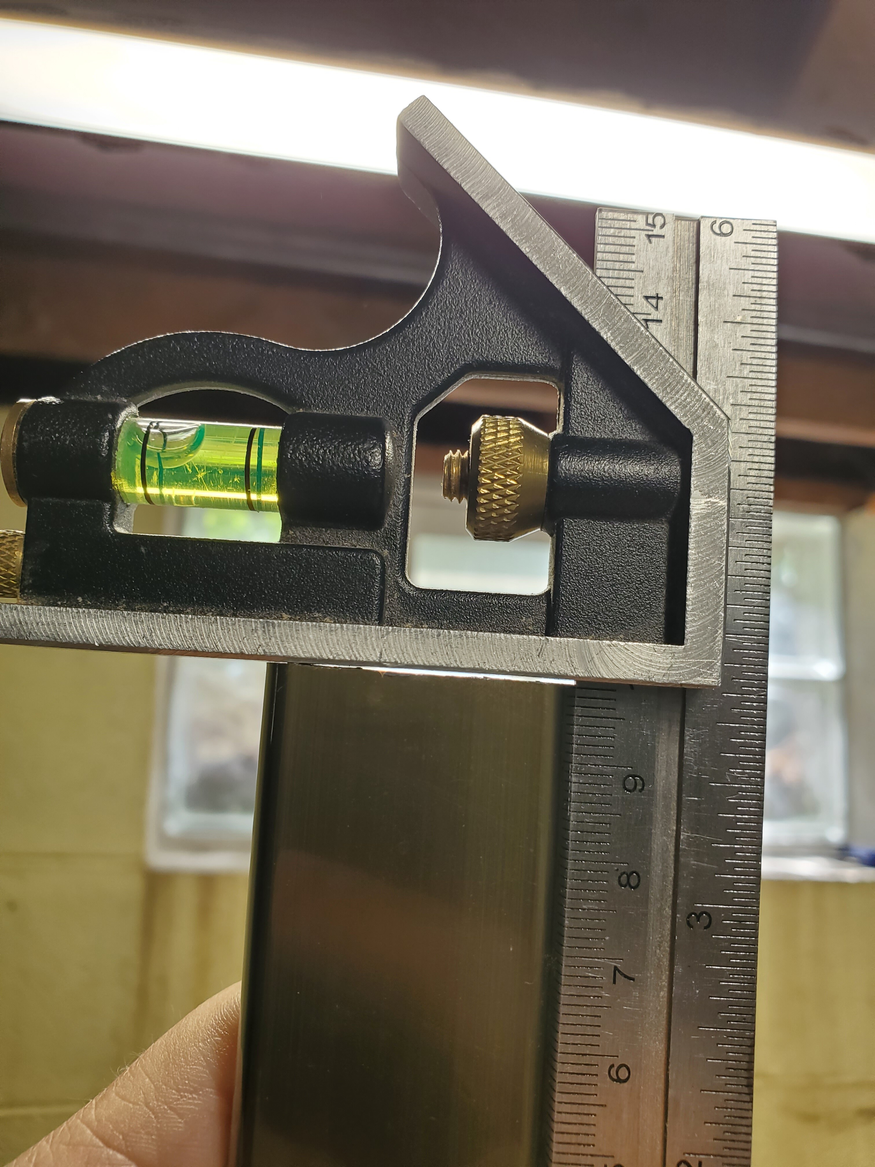

The rail was not cut square. I cleaned up both ends and it’s good now. Thank you!
