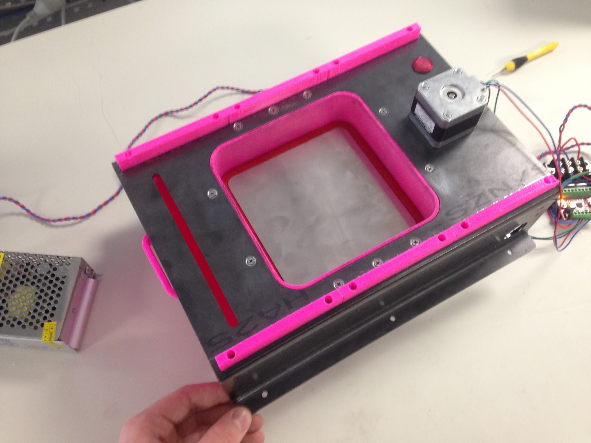

In the mean time, why don’t you pop that machine open and let us have a look eh?

@Jon_Gordon you probably already gathered that this is currently just a minimum viable test,
but here you go. https://photos.google.com/share/AF1QipNJx5XDwXTcH7UY9LHuFpJjeDR4E1qrQ1o6V9pmSzTrKO_X_R7KgAp0hclh-X619A?key=QmpnVlhCaFB0c3BDQmZHRnBZWTVKa2pwUXVHcldR.
