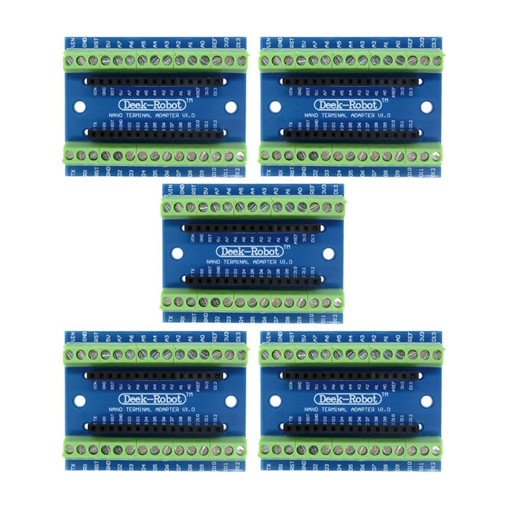

Were did you get that screw adapter for the processor board?
Never mind found one on Amazon
Yea i originally sourced mine from Wish.com
