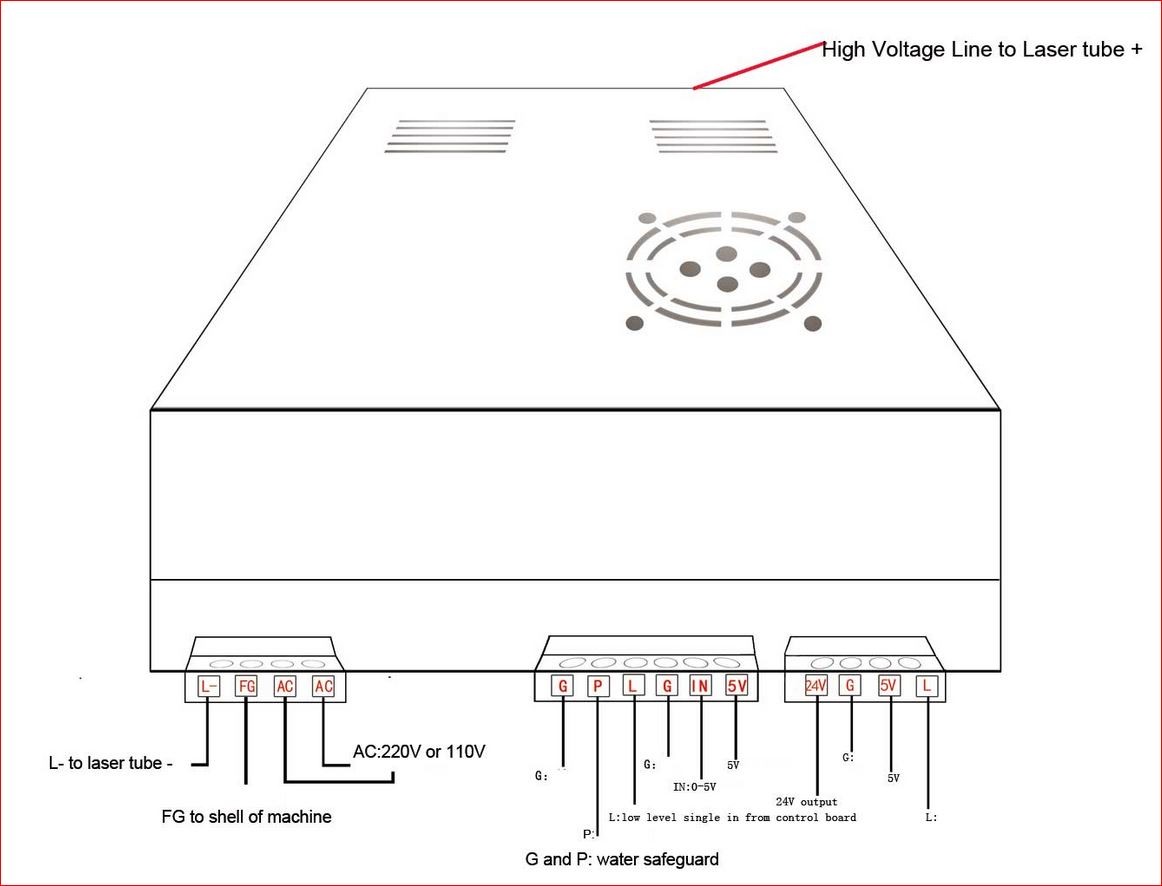

My PSU is this one, I think. All of my terminals use insulated ferrules aside from the ones on the far right (the last four). I have the tools to add the insulated ferrules to all terminals.
