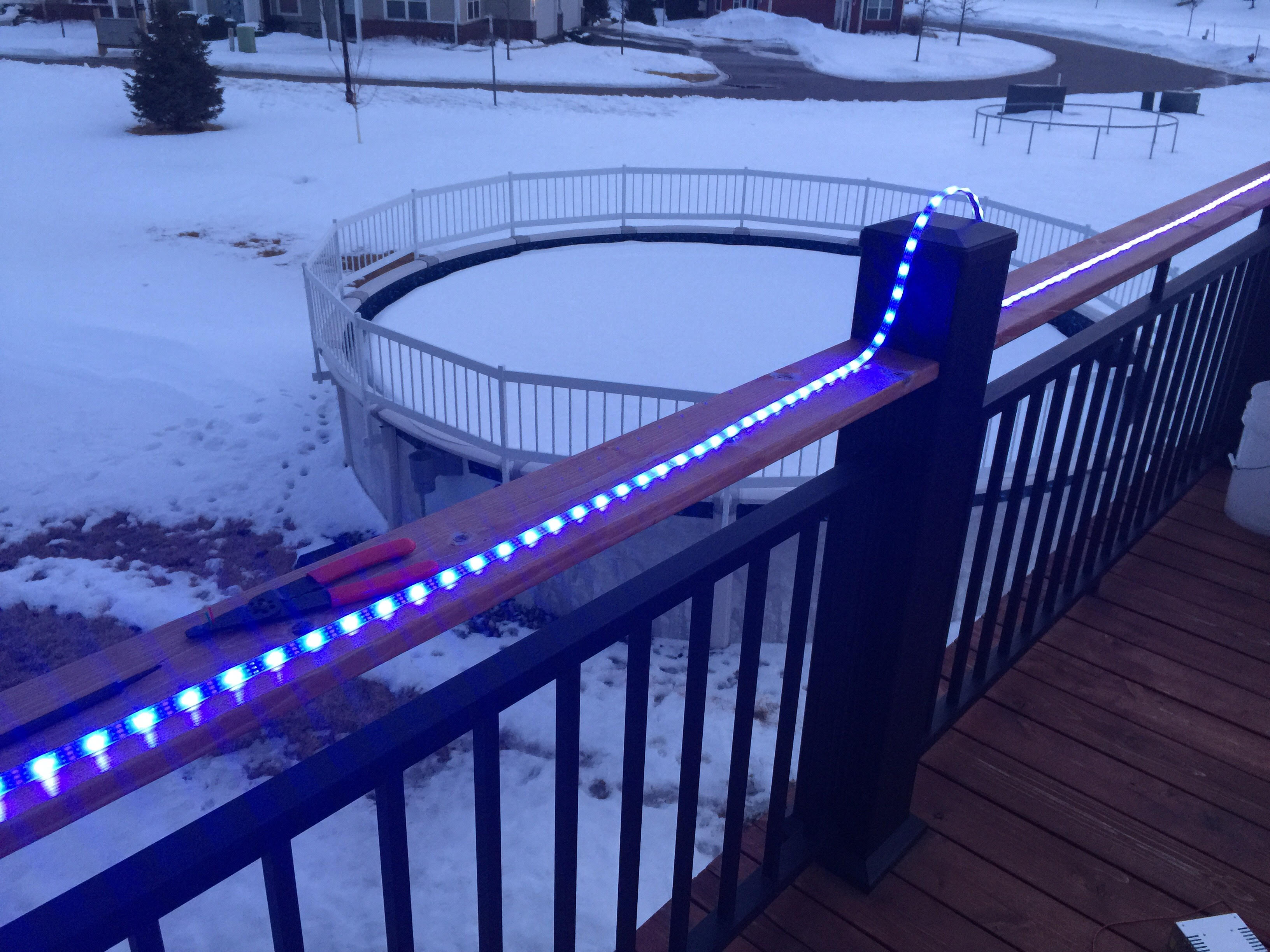

Doing a direct wire to 450 LED’s (yes that part works), but clearly this should not be the correct way as I have no relays, resistors, or anything else.
Currently just a 300w 6v 60a, a 6v 3v step down, a ESP-12E NodeMcu Dev, and WS2812Bs.
What else, if anything should I inappropriate into this?
