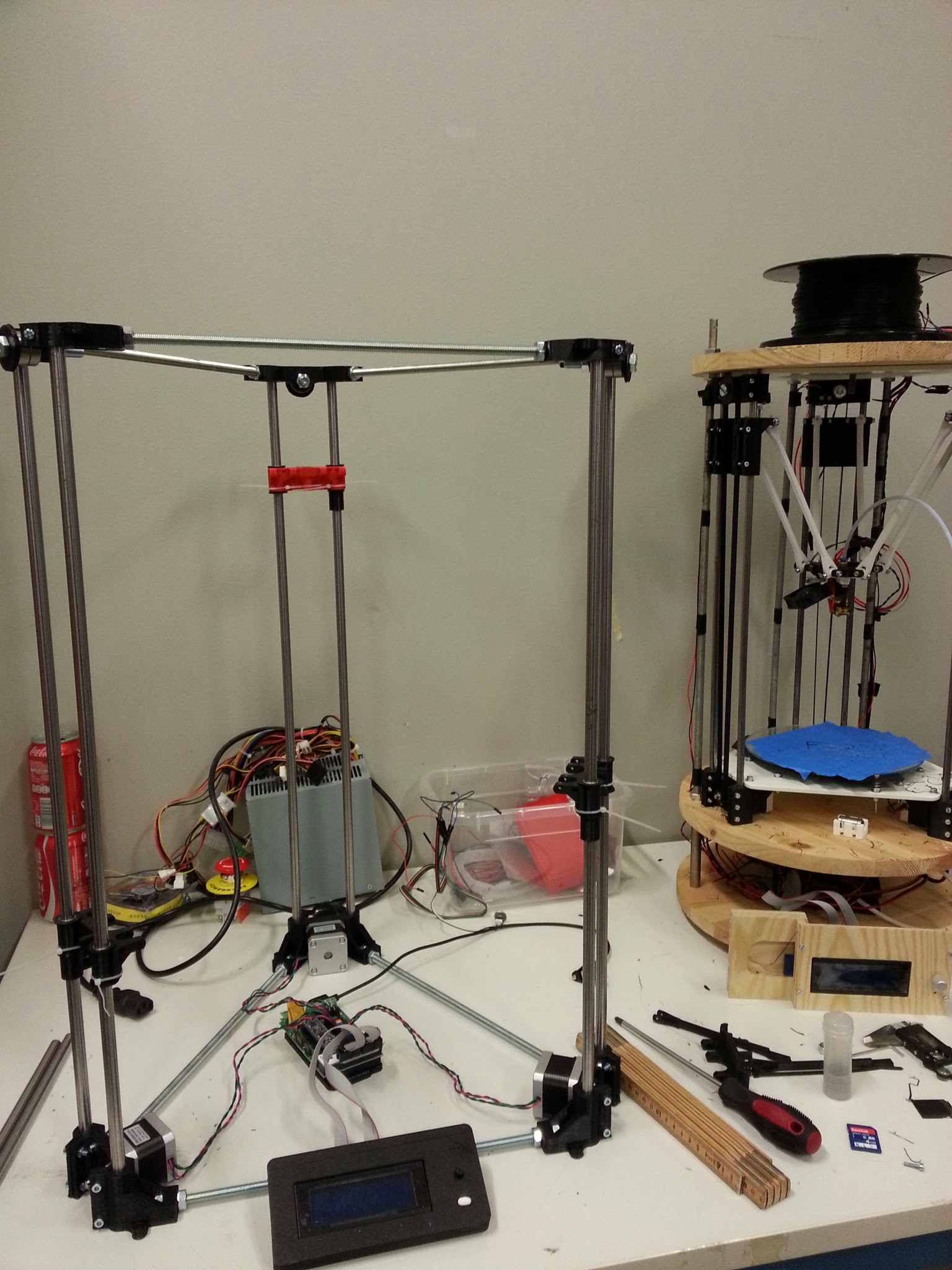

Geting there, alot larger then the first one
how stiff the frame is?
The frame itself is not that riggid, but the coming enclosure will add support.

I wonder if a cross-brace per side would do the job.
@NathanielStenzel my first build took me a year to complete, i had help alongside and u get skills if you have a passion and dont give up, so i say dont think, build
@Mark_Fairbairn the delta twists so yes a cross brace one 2 sides would make it rigid. But u have to take in to acount that the platform moves in cirkles, so the support must stay clear from it. my first printer is round, this one will use a hexagon shape and walls for support.
