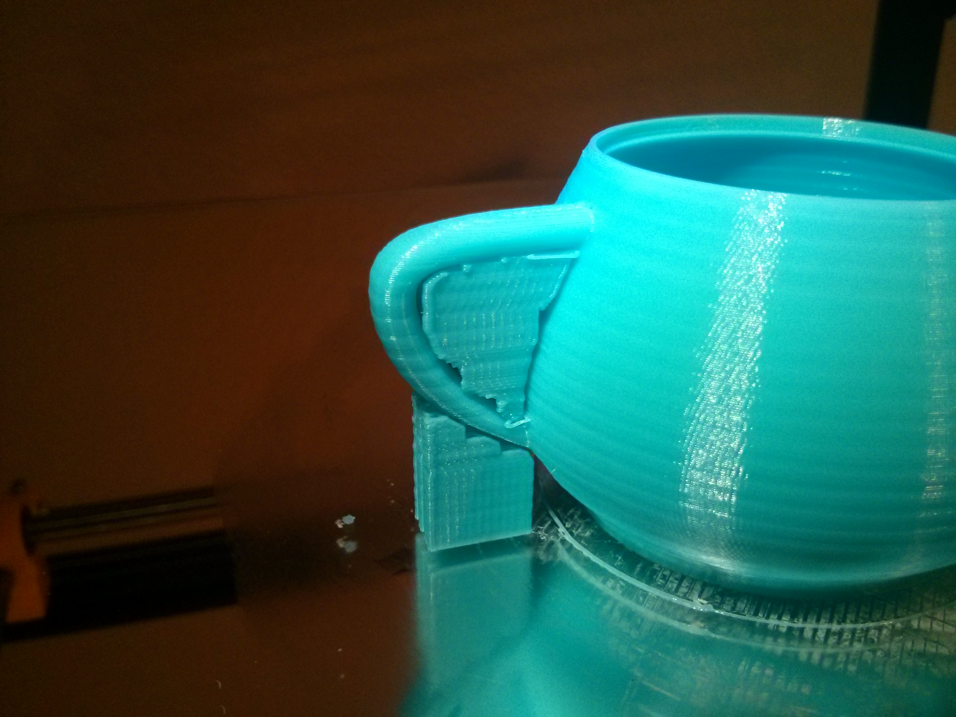

Getting a lot of z-ribbing still. It perfectly lines up with my leadscrew so I’m assuming some sort of software vs mechanical problem?
This is printed at 0.1920 layer height which according to the prusa calculator should be an even number of steps for the eustathios.
I’ve checked and its definitely not a wobble since the rib expands and contracts across the piece rather than to one side or the other.
This is on a 16microstepping smoothieboard, with the 20 tooth pulley on the 1.8deg stepper and the 32 tooth on the leadscrews.
I plan to try a bunch of other layer heights tomorrow.
It’s a nice effect on the teapot though.

As I see it it could be one of two things. My layer heights are not actually providing the heights I’m asking for hence the 0.1920 isn’t the correct value and I get classic z ribbing due to rounding errors. Possibly due to over or under extrusion causing the layer height to be wrong?
Or the hot end temp is fluctuating again and the filament is not extruding evenly (seems unlikely)
Or something I haven’t thought of yet.

However on this print the ribbing is at a much higher frequency, but the print is much smaller in diameter. So I’m thinking this indicates its definitely an over/under extrusion problem not a layer height one.

I just tried printing at 20% over or under my current estep value (changing it on the fly with M92) but that also seemed to make no difference. Oddly enough I finished the print at Estep value of 589, which is a full 20% more than the recommended 491 esteps recommended by @Martin_Bondeus for the bondtech v2 extruder. Even at 20% over the top layers were actually underfilled towards one corner of the print.
Now I can’t believe the extruder is that much out of normal bounds, even with the long bowden tube on the Eustathios. And given that its more on one side of the bed than the other I’m wondering if I have a levelling problem.I was under the impression though that after the first few layers a levelling problem goes away, so is only really relevant for the first 5-10 layers.

Yep, turns out all along that it was me being an idiot.
I failed to tighten the belt between the x axis motor and the 32 tooth pulley. So there was considerable backlash in the x axis which caused all of my problems. Just posted a new benchy that has come out wonderfully!
