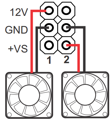

When connecting to the fan pins, should I be connecting to the Gnd and +VS pins or the +12V pins? The wiring diagram shows it either way, just not sure which is the correct way?
Also if I’ve got 24vdc power supply into the board, will it produce 12vdc or 24 on these pins? (My fans are 24v)
Use Vs. to get your main supply voltage (24V in your case). The 12V orientation is for 12V fans.
The board has a 12V converter on it for 12V accessories. This comes in handy for 24V users because some variations of fans, lights and other devices aren’t easily found in 24V.
For a visual representation, the fan on the left will run at 12V. The fan on the right will run at 24V (if you’re running a 24V PSU as you are).

Either of these sets of pins (fan 1 or fan 2) can be used with either 12V or 24V (your source voltage), depending on which pins you use (top or bottom).
