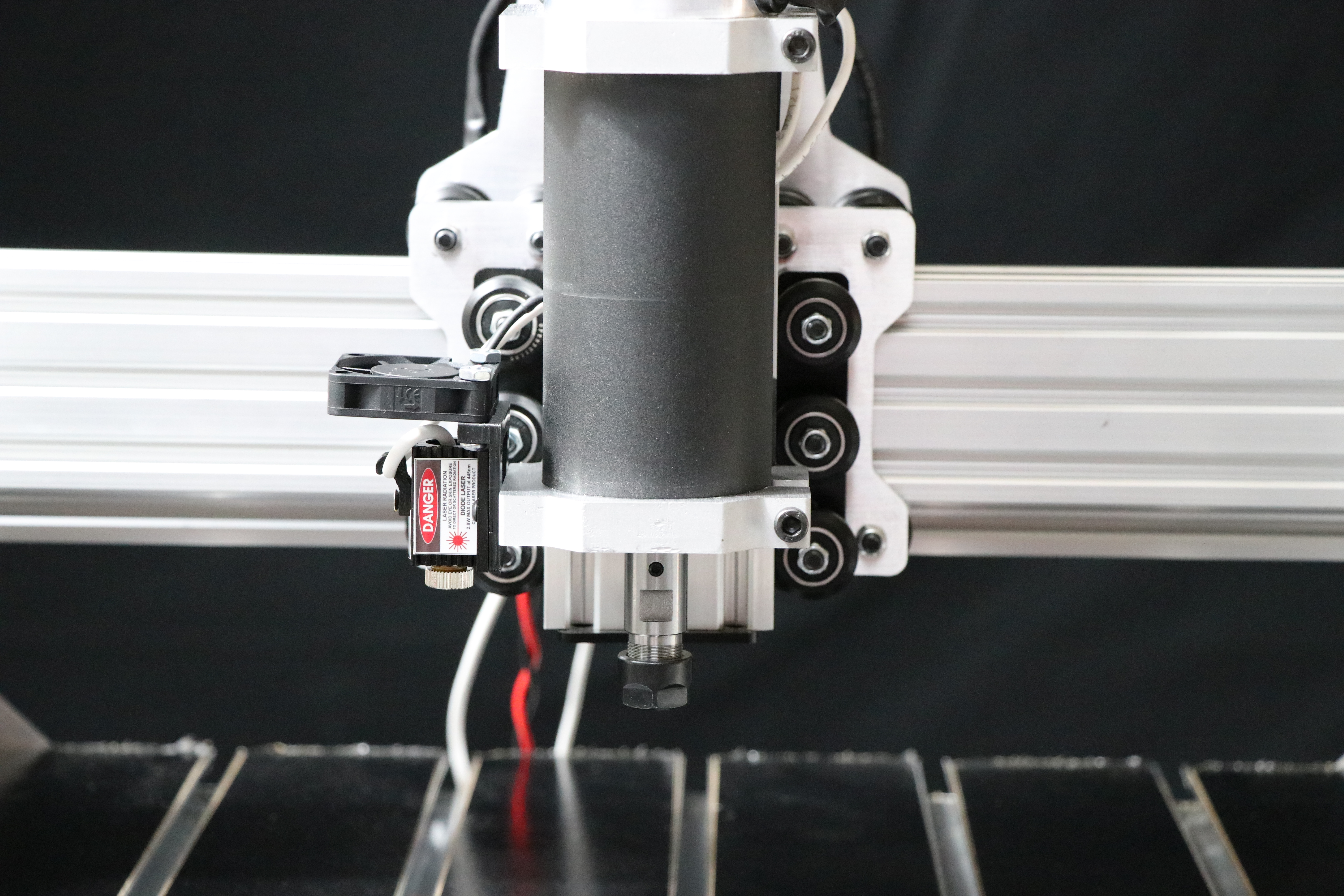

Getting an OX ready for a charity event tomorrow, a few new adds (before the kit goes to http://www.hobby-fab.com) captured in this build. Had a blast building it! Can’t wait to play with the laser again before delivery.
Tried a slatwall panel waste board on this one, not recommended, looks nice but is not flat. Internal stresses cause the board to want to curl from the slotting.

I thought of using slat board as well. They are nice to put on a wall to hang things but don’t work well at all on a cnc. I have gone with 3/4 mdf and a hundred threaded inserts. Tried T-track as well but it was always a pain to try and work the bolts into the track. Especially since my bed is over 50 inches long. Really thinking about building a vacuum table…

Is that laser for engraving? I’ve been thinking about attempting to try a laser distance device… So I can probe… Without touching anything.
@Chuck_Broten yeah man, think I’ve tried about everything and a flat piece of MDF is hard to beat. Even tried these with Al insets, just junk.
@Mike_Gallo if you are running a 71mm mount it probably does hit the screws. This and other mounts we sell, stay inside 60mm.
@Nick_Portelli it is an engraving/cutting laser. Neat idea on the probe. It would require you always cutting metal. One could use an optical but would have to spend the bucks to get a tight tolerance unit, post that some type of processor to change the distance measurement to a bang bang/ on off thing. Could certainly be done though.
