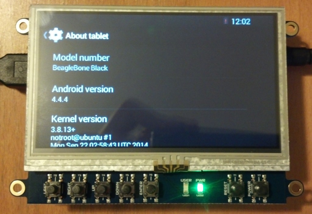

Getting AOSP Android KitKat up and running with the 3.8 kernel has been on my to-do list for a while now. After all, once we get the process in place for 3.8, 3.14+ should be pretty straightforward to get going. I use a file system creation process similar to how Rowboat does it for JellyBean, rather than the raw image writing process that @chris_simmonds has mentioned in the recent past for KitKat, so my partition structure is a little different compared to Chris’s. I don’t use a ram disk with the init process and .rc files inside of it with U-Boot, for example. There was quite a steep learning curve on the various pieces of AOSP, but the O’Reilly book “Embedded Android” by @Karim_Yaghmour has been a huge help in figuring it all out. I even managed to get i2c-tools built in as an additional external project during the AOSP build. Once I am able to get the process ironed out and documented, I’ll make some new pre-made Android images available for download.

A pre-made image and build instructions are now available at http://www.bbbandroid.org.
