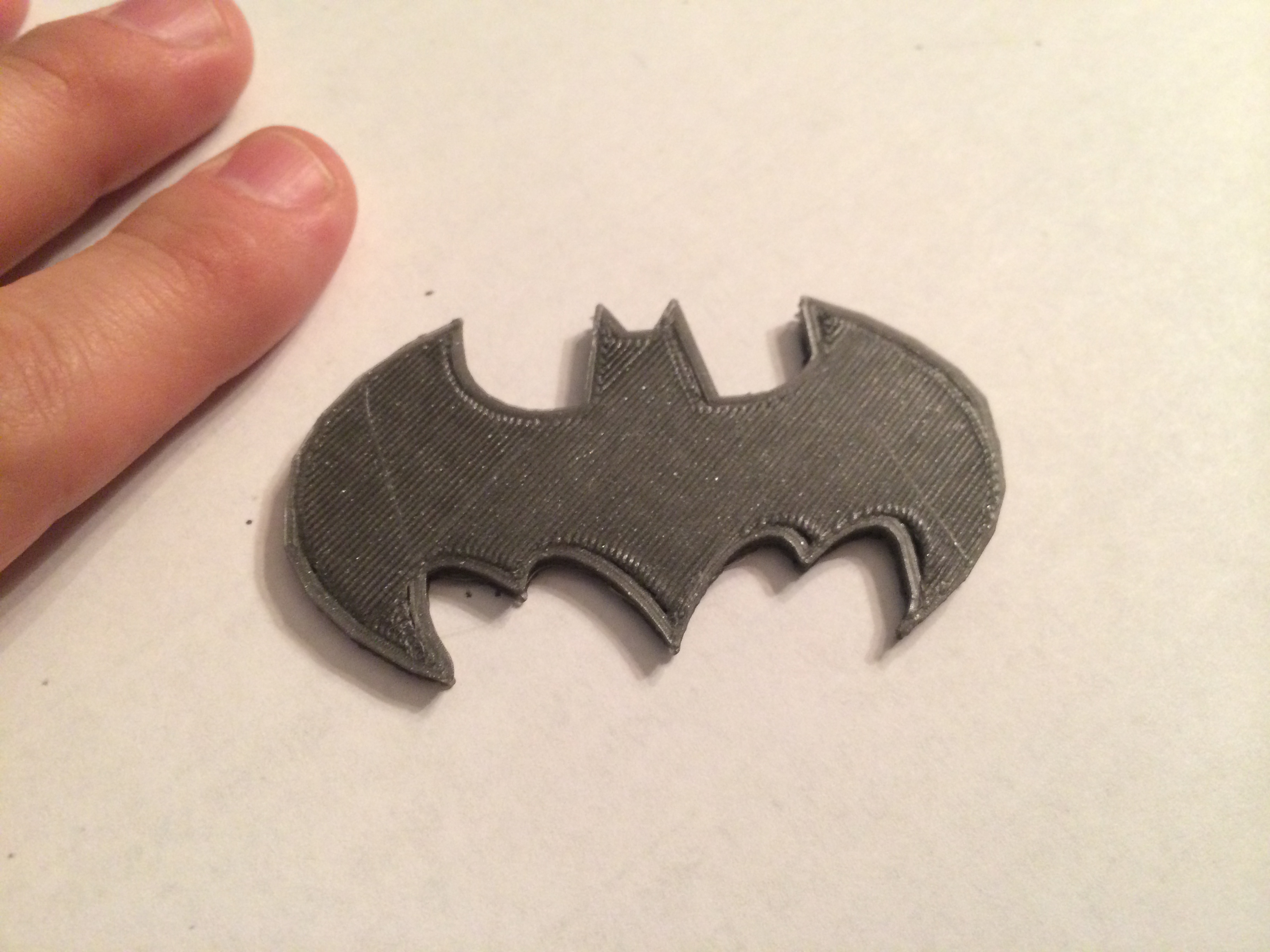

Getting better. Discovering that my E value was 4x too high mad a bug
Getting better. Discovering that my E value was 4x too high mad a bug difference.
they are looking great. Now your addicted. I have found that printing cookie cutters is fun, quick and really easy. My gf and mom love them as well. So everyone is happy
Some slack in, I’m going to guess, your X axis.
Why yes. The X is loose. How could you tell?
You can see some travel in the barman logo.
@Joshua_Marinacci , on the infill where it meets the edges of the perimeter. You’ll notice that from top-bottom it actually meets the perimeter. Going left/right there are gaps. This is how you can tell simply from the print what is wrong with the printer. X axis is either loose or has lash.
Ah. Excellent. This is the sort of stuff I need to learn. All going in my getting started guide. I bet a lot of people are getting Simples for Xmas and will need some help.
