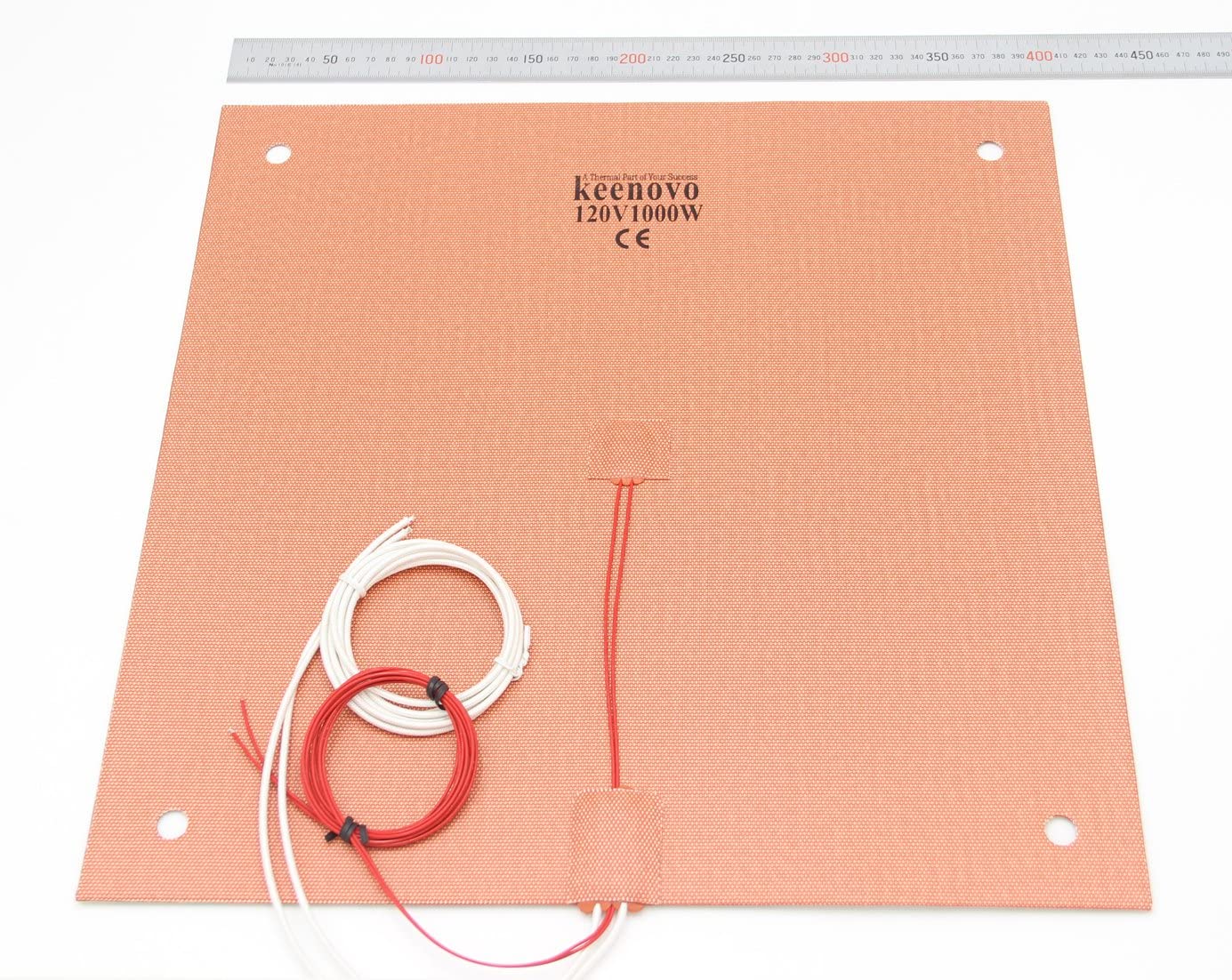

Frankly, I would rather just use something on the market, but since my bed is close to 400mm x 400mm, the stock solutions thin out awfully fast. Also, especially for larger heated beds, using AC rather than DC makes sense - which further limits easily sourced beds.
If I were designing an ideal bed, the bottom layer would be some insulating material (perhaps cork), next the heating pad (silicone embedded?), a somewhat-thick aluminum plate (to spread heat), and perhaps a magnetically attached thin steel plate with top-coating (as with the Prusa mk3).
