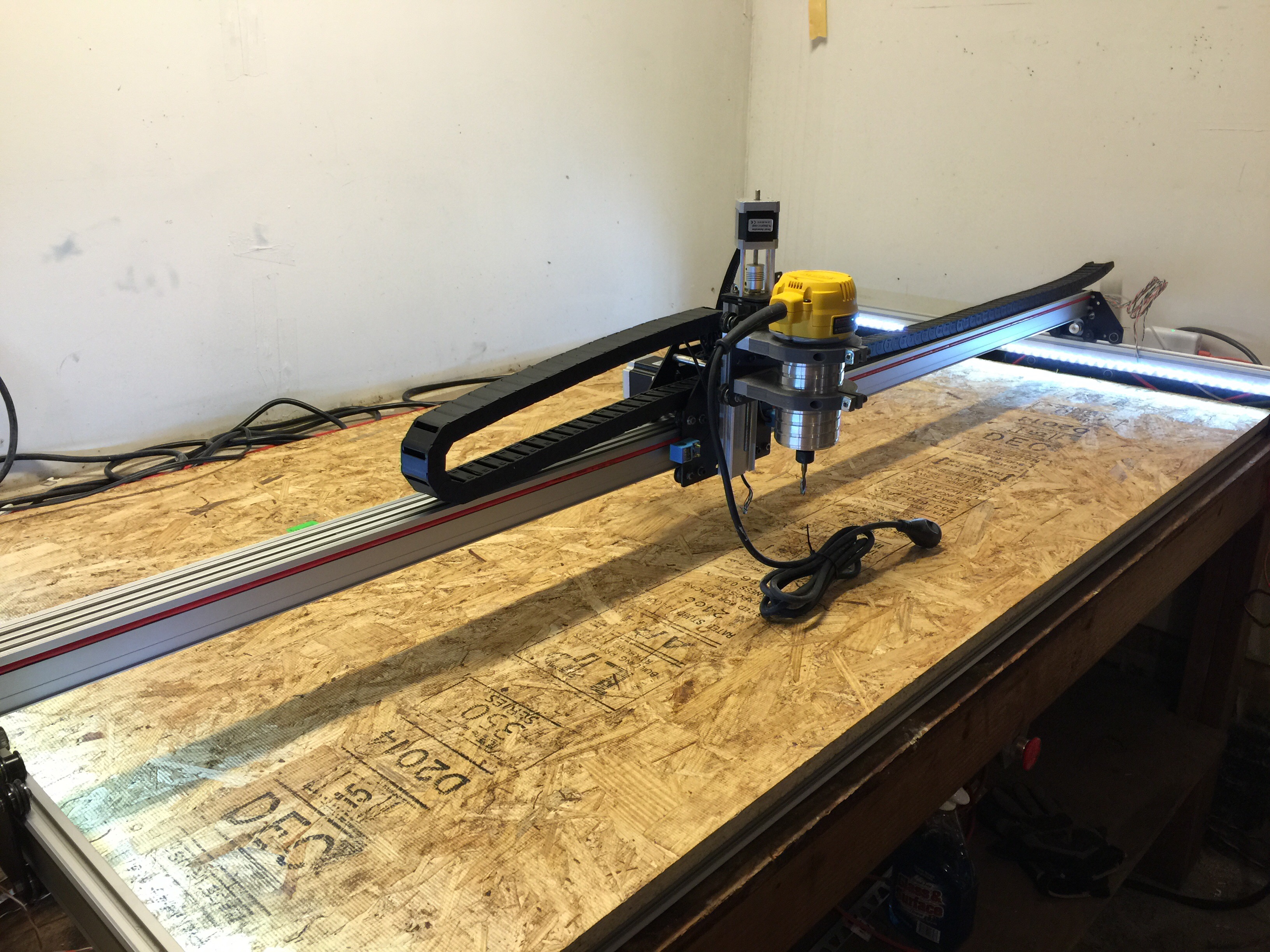

Getting close to completion.
Wow. So big.
Is that a full 4’ x 8’ sheet? Did you need to upgrade to Nemo 23 motors in order to handle the increased size? If so, did you choose to or was it necessary. Thanks.
1000mm x 1800mm (so roughly 40”x70”) NEMA 23’s? Yeah. I upgraded them for better performance.
Curious what you plan on making with that big area. I just built 1000x1000 to give me room to explore… But don’t have a specific set of projects in mind.
Did you do anything to stiffen the double makerslide?
https://plus.google.com/100117868275643909021/posts/MSMshk6V4or
As for the orientation, I have to be able to load materials in the machine. This was the best way (for me.)
Are your STL files for the brackets available for download anywhere?
